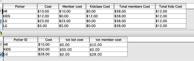

Yeah, I have tried the sum. This is a weird problem which seems to be because I'm trying to sum a calculation field. What's worse is that in the many table (Firing Slips) the sum works fine - gives the correct value - in the 'one' table (Firing Fee) Here is the data from the app
Firing Slips
Potter Cost Member cost Kidclass Cost Total members Cost Total Kids Cost
HR $10.00 $10.00 $0.00 $38.00 $12.00
KIDS $12.00 $0.00 $12.00 $38.00 $12.00
LG $23.00 $23.00 $0.00 $38.00 $12.00
LG $5.00 $5.00 $0.00 $38.00 $12.00
Firing Fees
Potter ID Cost tot kid cost tot member cost
HR $10.00 $0.00 $10.00
KIDS $50.00 $50.00 $0.00
LG $28.00 $0.00 $28.00
and here are the table definitions
Firing Slips
Field Name Field Type Formula / Entry Option
Potter Text Indexed
Member cost Number
Cost Calculation Unstored, = If ( Potter = "KIDS" ; Kidclass Cost; Member cost)
Total Kids Cost Summary = Total of Kidclass Cost
Total members Cost Summary = Total of Member cost
Kidclass Cost Calculation Unstored, = If ( Potter = "KIDS" ; (50 - Total members Cost); 0)
Firing Fees
Potter ID Text Indexed
Cost Calculation Unstored, = Sum(Firing Slips::Cost)
tot kid cost Calculation Unstored, = Firing Slips::Total Kids Cost
tot member cost Calculation Unstored, = Firing Slips::Total members Cost
In the Firing Slips table, you can see how the entry in the 'Cost" colum is correct, but in the Firing Fee table, while it is correct in two of the cases, in the third case it is the total of all the costs from firing slip, not just the one Potter Kids
I just don't understand - if I change the item Kidclass Cost to a number from a caculation, and put a value in it, then the carry over caculation in Firing fee works.
I'm Stumped - Anybody got any ideas? (data nd definitions taken from attachment)
