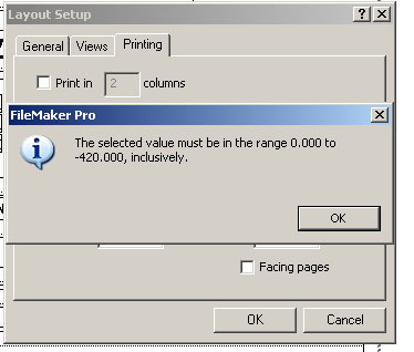

I just upgraded from Filemaker v5 to v8.5. on some of my layouts they are not printing. So I went into Layout setup, tab Printing, and i'm getting this error:
"The selected value must be in the range 0.000 to -420.000, inclusively."
after clicking "ok" the cursor is on a box, so I try to change it. the error pops up. I try to change it into the range, error pops up. I try to move to another box, and the error continually pops up, even when I click OK. Attached is a picture of the error. I have a feeling it has to do with the upgrade. Anyone got a fix for it?

Updated: the Fixed margins are top=5.50, Bottom=5.50, Left=214.00 and right=214.00. I believe these are making the pages blank. I tried to set them but I got the same error, except with "range 0.000 to 0.000"
ARG
Ok. I think I got it fixed. I had to do a Recovery of the file and the error has gone away.
Drawback is that all the Margin settings are screwed up so I have to reset them. But at least when I change them this time, it does NOT have issues.
