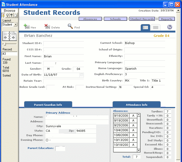

I'm working on a database that I will use in a school district to report on Attendance information. Attendance is tracked by our student information system, and I'm exporting that data to FMP.
Incidences of attendance are identified by letters. For example a "Tardy" is identified by the letter "A", Tardy +30 by the letter "B", Unexcused Absence by the letter "C", etc. The attendance codes range from A through L. With each letter representing a unique entry.

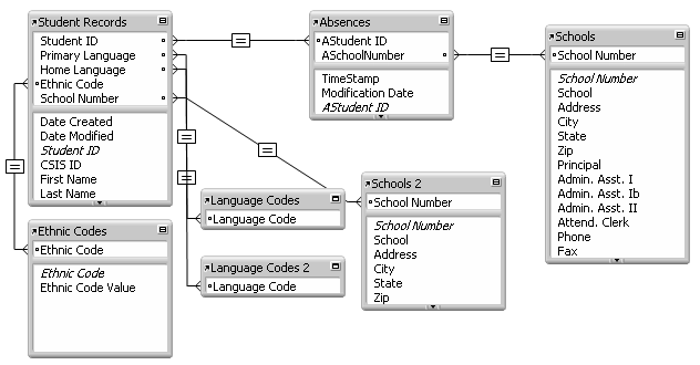

I've designed the database from the perspective of wanting to identify instances of Attendance and link them to students. That seems to be working well. But I'm now trying to figure out how to identify those with no entries for certain codes. For example, list every student at a school without a tardy. Or, list every student at a school with perfect attendance, or no absences.
I'm looking at my table relationships and I'm not seeing how I'm going to sort that out. (Note the attached graphic) I've been playing with finding and sorting through the absences table, however I'm thinking I'm on the wrong track with that.
Any help in the right direction would be greatly appreciated.
Thanks.
- Sez
There may be other ways to do this, but I might try this by adding a text field with global storage to the Student table, maybe call it gAbsenceType, and use this as a filter for another relationship to the Absence table:
Student <=>Absence by AbsenceType =
Student::Student ID = Absence by AbsenceType::A Student ID
AND Student::gAbsenceType = Absence by AbsenceType::AbsenceType
You can then define an unstored calc in the Student table to show the count of absences of the selected gAbsenceType. From this, you can build a report to find the records having the desired count.

Your response has made me rethink the process. Note that I have a portal taken from the attendance table that identifies the attendance records for individual students.
Now I'm wondering if there is a way to leverage that to display the information I want by school, or will the global field solution be more effective in the long run?

Well, you could do the same type of thing in the School table, but with thousands of related records, those calcs will end up being pretty slow. It might be better to set up a similar structure, but use a script to calculate the aggregates and populate regular number fields.
Alternatively, you could build a columnar report with sub-summary parts in the Attendance table, and get counts in a report format for each School and each Absence type.

If it's important to see the counts for each Absence Type at the same time, then yes, going with a global for each with a corresponding relationship (TO) to the Absence table would be fine.
Or you might define regular number fields for each, just use the one global, and use a script to loop through all the Absence Types, populating the Counts for the record. This second option involves a little scripting, but the relationship graph is kept cleaner. Another advantage is that the Counts would then be stored, making any Finds on them faster.
