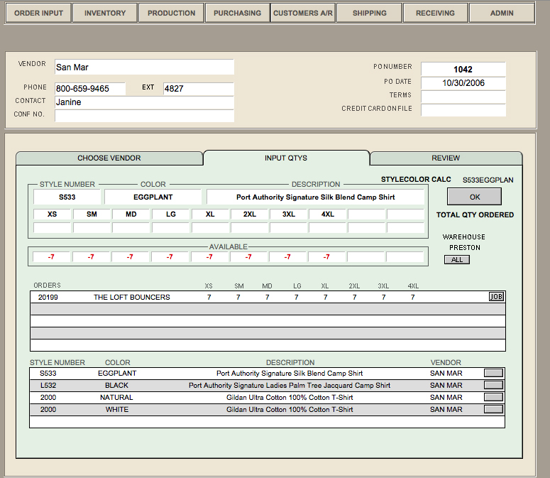

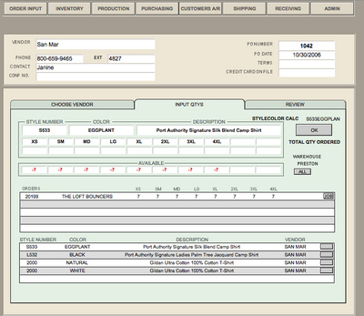

I will have to ponder this new example a bit. It agian looks very interesting. I have attached a screen shot of my Purchase Order Input layout. PLease excuse the stray fields and buttons, I am in the process of reining my interface. The bottom portal is where I am using this relationship. The items displayed in the portal represent the group of items which have a negative value in "Available". The button in the portal row is used to choose the item to buy. The portal above it displays the various orders the item is needed for. The user can click the "job" button to poulate the order quantity fields with that jobs quantities regardless of the available quantities (we quite often buy shirts by the job, even if we have some of that item in stock). The user also has the choice to click the "all" button to buy all needed quantities of the item. The solution you suggested yesterday worked very well, and only required a short simple script and an additional field.
So if I get it right is the process to choose vendor, and by the selection is the next tab chosen. In the lowest third is a shirt-type and a colour selected by the button to the right. What happen is that two global fields is filled with... - here S533 and eggplant, which pulls up two horizontal portasl of the same relation, one showing only the sizes that holds a negative stock the lower and the upper a lot of empty fields in the same table to fill in the desired quantitees, using the summary method I just have shown.
When an order is processed are these numbers turned into new adjustmens of the storage, by making the needed number of records, while the numbers entered are cleared, so they don't show up the next time you hit a certain shirts button.
