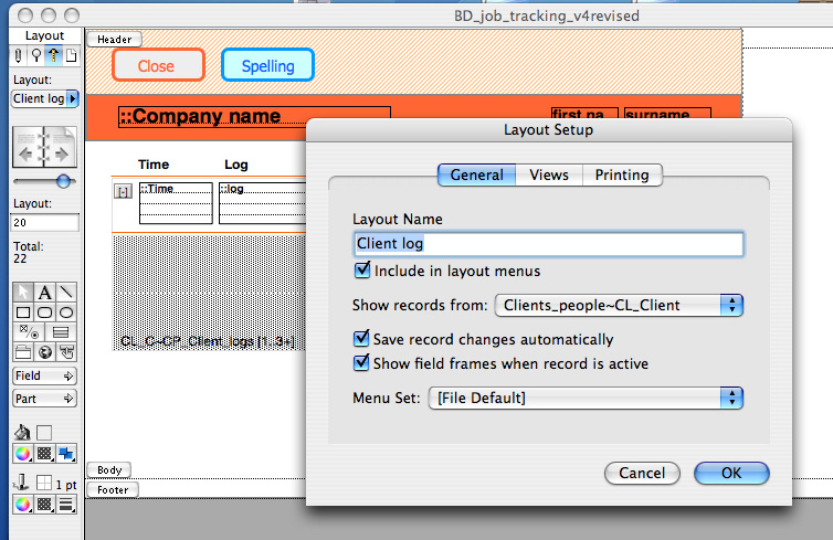

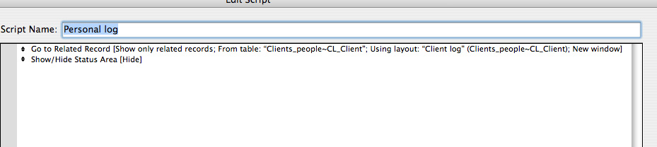

HI- I didn't have time this morning to modify the file and send it back- then tonight, I had a freaky Haloween occurance with stuffit, and cannot compress the file to send you. It is really quick and simple, so I just took screenshots of the two changes you need to make. You need to change the layout setup for client log to show records from client people, and change the GTRR in the personal log script to go to records from client people. Hope this is what you're after !
