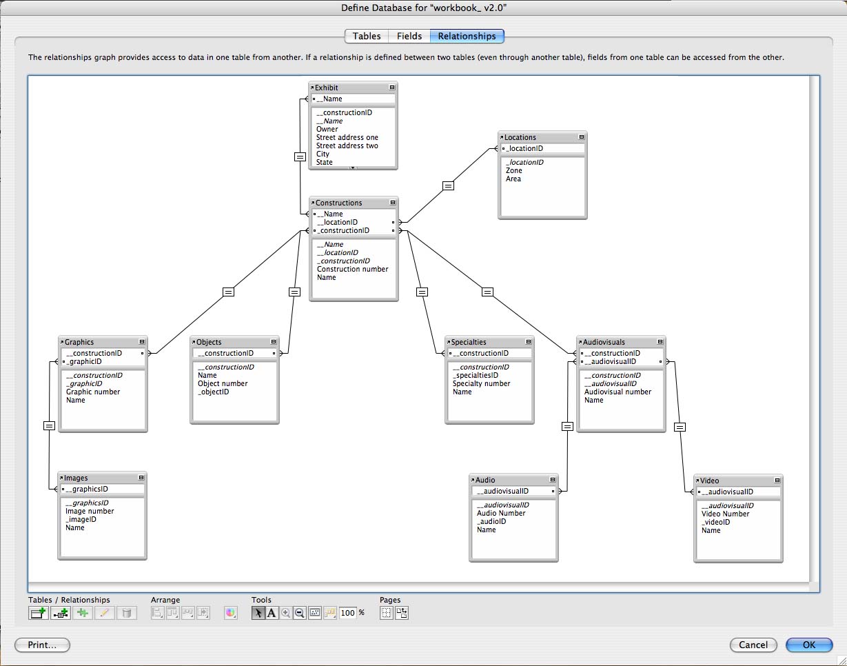

If you get stuck, it will help us to have some actual tables and fields to talk about. Maybe even a screenshot of the relevant part of the relationship graph.

But, It occurred to me that I can set up my relationships a little differently and achieve what I'm looking for.
I've attached the relationship graph though, in case anyone is interested.
