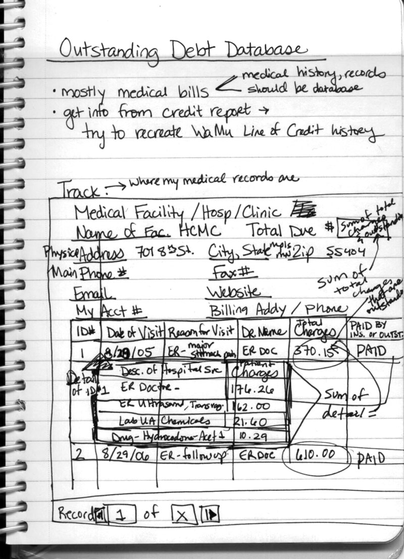

I want to create a table inside a table inside a table.
I want to draw a picture to make it easier & I just realized I can. I've attached a scan of my draft sketch of this. Hopefully that will help. (Sorry it's messy - I was just doing it for myself when I drew it - hopefully still useful though.)
If you need to me to redo sketch cleaner I can. Thanks!
You could fairly easily create exactly what you have in your drawing, but it would be a little tricky to show it in Browse mode. You could create it fairly easily for printing in Preview mode, using a Subsummary part for the data that only appears "occasionally", ie., the ID and dates. You would do that as a report in the bottom level "visit_treatments" table.
"So how would I make a sub-table for each visit?" What you're calling a "sub-table" is just a table which is a child table of a parent table. It is common to have tables in a hierarchy:
Patient ->visit ->visit_treatments
Each one of these tables can view "up" to its 1 parent, down to its many children, and/or down to grandchildren (if any).
One problem with what you show in your drawing is that the ID and Date do not appear on every line. But what really makes it difficult (if not impossible) is that you have "visit" data on one line, then multiple lines of "visit_treatment" data on the following rows. As you likely know, portals don't normally work that way.
The "visit_treatment" data you show below the visit date data is related data, visible by looking down "thru" the Visits table, to the Visit_Treatments table.
It is possible to "gather" related data however, and put it into the portal, under the "visit" data. One tool I've used are 2 Custom Functions, GetRows and GetNthRow, by Bruce Robertson, available at:
briandunning.com/filemaker-custom-functions/list.php
They could gather your visit-treatment data into a single calculation field, in Visits, tab-separated, so you could likely format it to look like your drawing. You could not however enter that data there; that's going too far. The visit-treatment data would be on the same row of the portal with the visit data, but they'd look as if they were in further table.
One (big) problem though. You cannot control the size of the rows; they are not going to expand or shrink to accommodate the number of visit-treatments. This is another reason why what you want to see is really only possible as a report with a subsummary for visits.

Yes, what you wanted to see as a portal would be fairly easy as a sorted report, in the visit-treatments line item "sub" table, with the Visit data as related fields within a Subsummary part.
If you're going to view records for multiple patients at once, you'd need 2 Subsummary parts, the top one for Patient data (sorted by Patient ID), and the lower one for Visit (sorted by Visit ID). It will produce a hierarchal view. If only viewing one patient then Visit ID is sufficient; the Patient data would just be in the Header (or Title Header) part.
Both of those ID fields can be auto-entered by an "Allow creation of related records" relationship from Visits.
The view would be scripted, so it can Sort, then go into Preview mode. To get something cute you could pop this up in a new sized-to-fit window. Then, when you're done looking at it, close the window.
