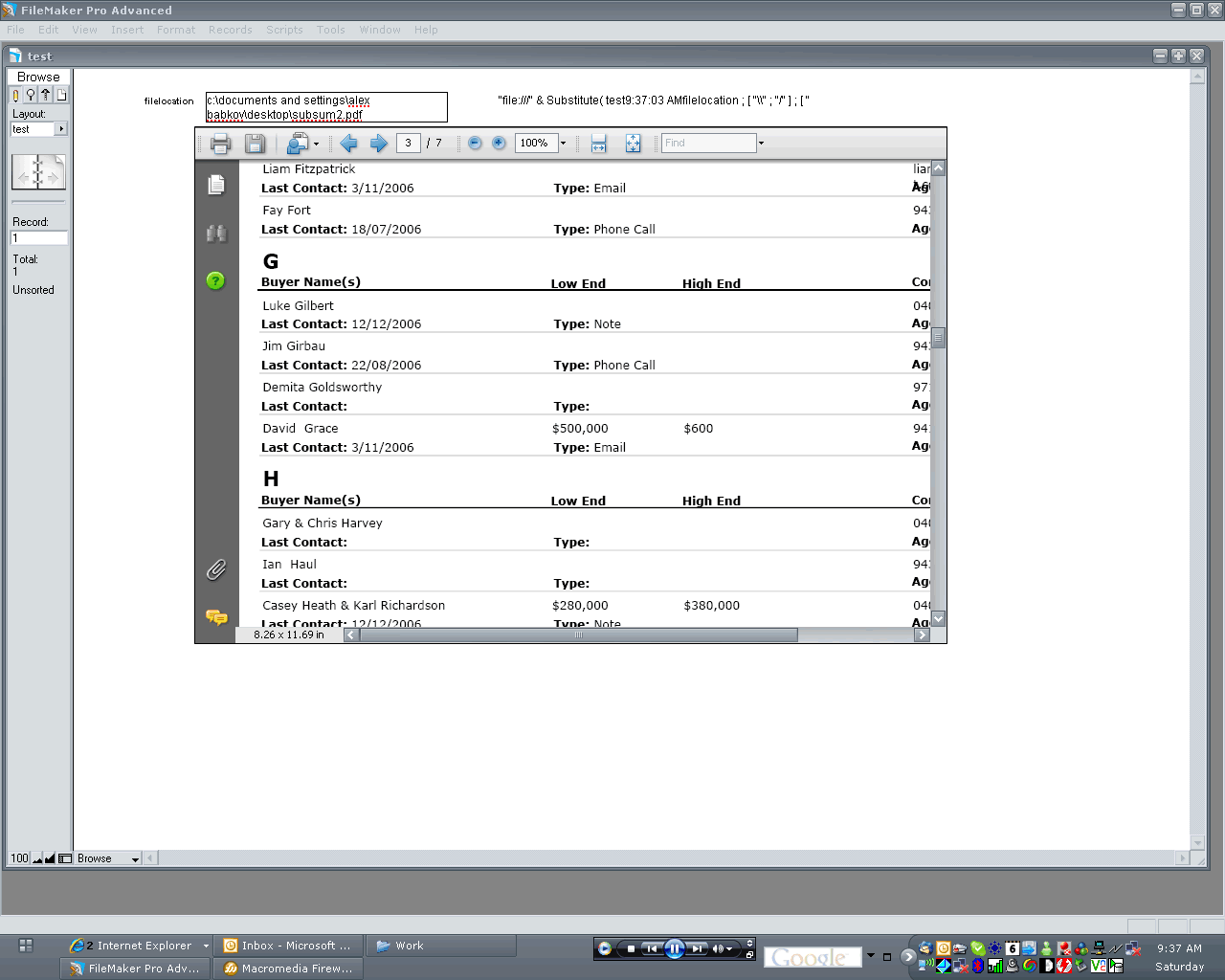

... why don't you just store the filepath and for 99% guarrantee it will work store the path as:
file:///C:/Documents%20and%20settings/user/desktop/mypdf.pdf
(PS: The string you see in the top right is just the webviewer address, which should actually be:
"file:///" & Substitute( test::filelocation ; [ "" ; "/" ] ; [ " " ; "%20" ] )
You should be able to view PDFs as either local "file:///" or via personal web sharing as "http://". Can you view a PDF in your browser? The same path should work in the web viewer.

You could always export it to a "temporary" location whenever you needed to use it...
Oh by the way, after further playing.. The web viewer will accept a standard windows filepath e.g. "C:File.pdf" and convert it appropriately by itself.
