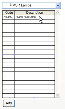

I’ve tried playing with some hierarchy solutions with the +/- buttons, but I wasn’t able to figure out how to integrate it into my solution. If I were to have 2 drop-downs (or even 1 if possible), and they could select the category and then the items would appear on the tblProducts portal, that’d be great! I’m guessing this has something to do with applying conditions on what is displayed and what shouldn’t be shown.
I’m still in the planning stages, but I threw together a quick sample of where I’m at now and a picture of what I’d ideally like. Any help would be appreciated ???

Now, as far as making it pretty... is there any way for me to have a drop-down formatted like this..
Group 1
  └— Category 1
  └— Category 2
  └— Category 3
Group 2
  └— Category 4
  └— Category 5
I'm sure it's easy.. but I cant seem to wrap my head around how to go at it.
