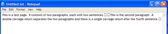

Hopefully, this is an easy one. As shown in the screen copy below, FileMaker inserts "non standard" carriage returns in text exported under WinXP. The file was produced by right-clicking on a text field and selecting Export with the filename of Untitled.txt -- and then opening with Notepad.
Is there a simple way to either 1) instruct FileMaker to insert proper CRs during the export operation or 2) replace FileMaker's carriage returns in the text field itself with proper carriage returns before requesting the export?

Export records to a new text file and the proper CR's will be used.
The file size will also be about half the size of the original export as using Export Field Contents puts an extra character between each character exported (use a Hex editor if you are curious).

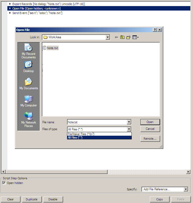

After repeated tries, I was unable to make any progress using your suggestion. For simplicity's sake, I used the right-click field export for the example in my original post. What I'm actually trying to do is build a script to export the contents of a single text field. The Open File script step requires a FileMaker file and I found no option for a simple text file.
Did I interpret your suggestion correctly?
This is what is I'm seeing at the script-level dialog. Is there some other option?
Apparently the Open File script step and manually using the menu command File>Open do not work the same. My previous directions were for a manual import, I missed that you were trying to script it until just now.
I have attached a file showing how you might get the export you want through scripting. Two things to note:
