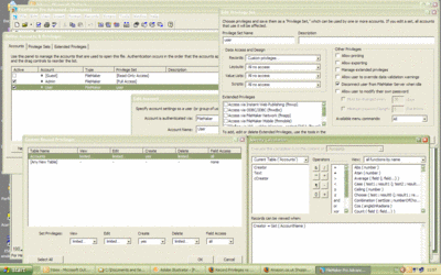

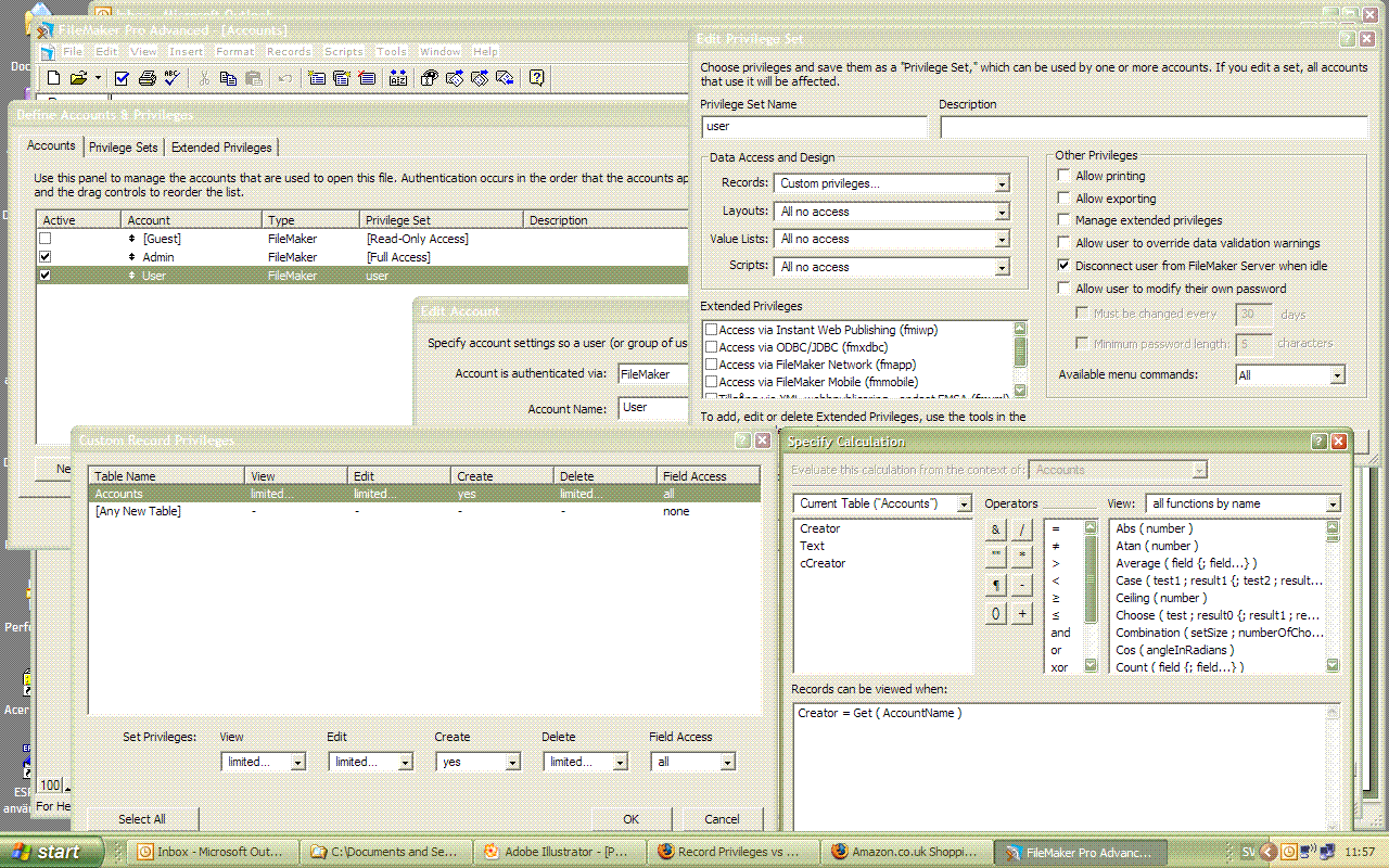

This might be below the general knowledge level of the forums, but I have enclosed a screenshot of the account settings of the generic test db.

Your security was so "pessimistic" it was clinically depressed :-] You'd disallowed access to any layout or script. So they couldn't see anything no matter what. And you can't find their records without a script. So I turned those back on. You may choose to limit them later,* but they've got to be able see something, and run a "startup" script.
I changed your Exact() to just Creation field = Get (AccountName). Your data had mixed case. And people are liable to log in either way, as the account name is not case-sensitive. If you want to enforce the case, then tell us; I couldn't tell.
With a file where every table is view access-restricted it is easiest to use a Find to get them to their records. A relationship works fine IF they have access to the table's record the database opens on; otherwise it's a Catch 22; they have no access to even a Get (AccountName) field, so the relationship can't resolve. A relationship works fine if you have another unrestricted table to start from.
Another action you must control is Show All Records. FileMaker will automatically restrict other Finds to the access-restriction; but Show All Records overrides that. So script it. I'm using the same script as the startup; but you may want slightly different steps for Show All. You need to decide whether the Admin also wants to Find their own records at startup; even though they can see all.
One other point. Your User privilege set had "All" as the Menu privileges. It should be either "Editing Only" or "Minimal". All allows such things as Replace Field Contents [], and a few other dangers.
*It is very cool that removing access to a script not only stops them using it, it removes it entirely from their visible Scripts menu (if any).
