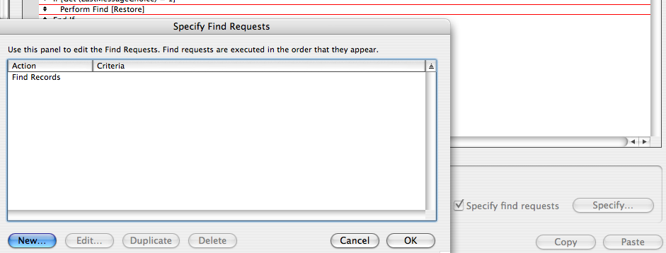

I have a button with a script that is intended to perform a Find using a value entered into a custom dialog.
This script generates an error alert rather than performing the Find.
As shown in the screen captures in the attached zip file, 1) the input field is assigned to button 1 (default; rightmost) in the custom dialog, 2) I am typing a correct value ("March") in the custom dialog, and 3) if I type "March" into the target field that is referenced in the Input Fields tab in the Custom Dialog dialog, the Find functions properly.
What have I done improperly and what is necessary to correct it so that the script will perform the Find after entering a search term in the custom dialog?

Here is some additional information.
FM Help contains an example of using a script, custom dialog, and input fields to perform a Find. In the example, the script line Perform Find includes [Restore].
This means that the example assumes a Find Request has been specified in the Edit Script window for the Perform Find command; otherwise, the example's script line would be "Perform Find []" rather than "Perform Find [Restore]."
I therefore specified the Find Request as shown in the attached screen capture.
I have run the script after having deleted the Find Request specification. Instead of displaying an error alert, the script returns to my original layout.
How can I fix this so that it works properly?
Thanks in advance!
The option 'restore' in the perform find script step means that you perform an older query saved in this script. Surely not what you intend to do.

If I uncheck the "Specify find requests" checkbox for the Perform Find command in the Edit Script window, then the [Restore] is removed from the Perform Find command.
I then execute the script, type "March" (without quote marks) in the custom dialog, and the script returns to my original layout without having found the 24 records for which the Month field contains March.
Do you have a different suggestion that would solve this problem?
