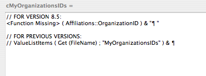

I have been playing with the attached sample file for the dwindling value list, but have struck a problem in that the dwindling list only displays if there is already a value in the matchfield. If the matchfield is empty (or contains just a pilcrow) the value list doesn't display.
The value list depends on an inequality (≠) relationship between a calculated field and a related field from which the values are drawn, but Filemaker doesn't seem to evaluate it if the calculated matchfield is empty, even though the window is refreshed via a script.

I have managed to work around it by having the calculation set a "nonsense" value if there is no valid relationship, but is there a better/more "elegant" way?
In the calc, make following change:
// FOR VERSION 8.5:
"~¶"& List ( Affiliations::OrganizationID ) & "¶ "
// FOR PREVIOUS VERSIONS:
// "~¶"& ValueListItems ( Get (FileName) ; "MyOrganizationsIDs" ) & "¶ "
...allthough there seems to be done something like it; a in the end, that you perhaps have ignored

Thanks Comment. The file indeed does work.
After editing the Calc.
Attached is the calc as provided. I am using FMP8A and there is no "tiny space" after the final pilcrow. No conspiracy either.
Soren's post just pointed out that the calc for pre-8.5 versions needed to be finished off same as the 8.5 version.
OK, now it makes a little more sense. I didn't notice your application version, and I have never tested the calc on version 8.
The strange thing is that it does work "as provided" in version 7 - but not in version 8.5, and apparently not in version 8 either (I don't have 8 installed).
The cure is indeed to change the calc to:
