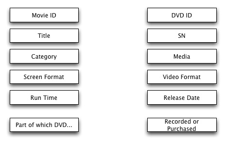

I want to manage my DVD collection (documentries), and my dilema is how to go about it.My DVDs would be purchased or recorded. The recorded DVDs could contain many movies, some fields in purchased would not apply to recorded ones. I attache a sketch of my 2 tables which I am after. Any hints in fundamentals how I can achive it, please!
You've probably got to separate information about the movies themselves (Titles) from the media they are stored on (Disks). Just about all the information you list above is either Title or Disk related.
Since a Title can be on more than one Disk, and a Disk can have more then one Title on it you're going to need "join" file. In Library cataloguing circles it's usually referred to as a "Segments" file. Titles can be split into multiple segments, and a disk can contain multiple segments.
So you need three tables, Titles, Segments and Disks.
A large part of the design of your database will be determining your own "business rules" that is, what you deceide you want to call things and how you want to categorise them.

If you curious what I did before I posted a topic, take a look at attachment.
I was not happy with design, however this is the closest picture how I want the things work.
