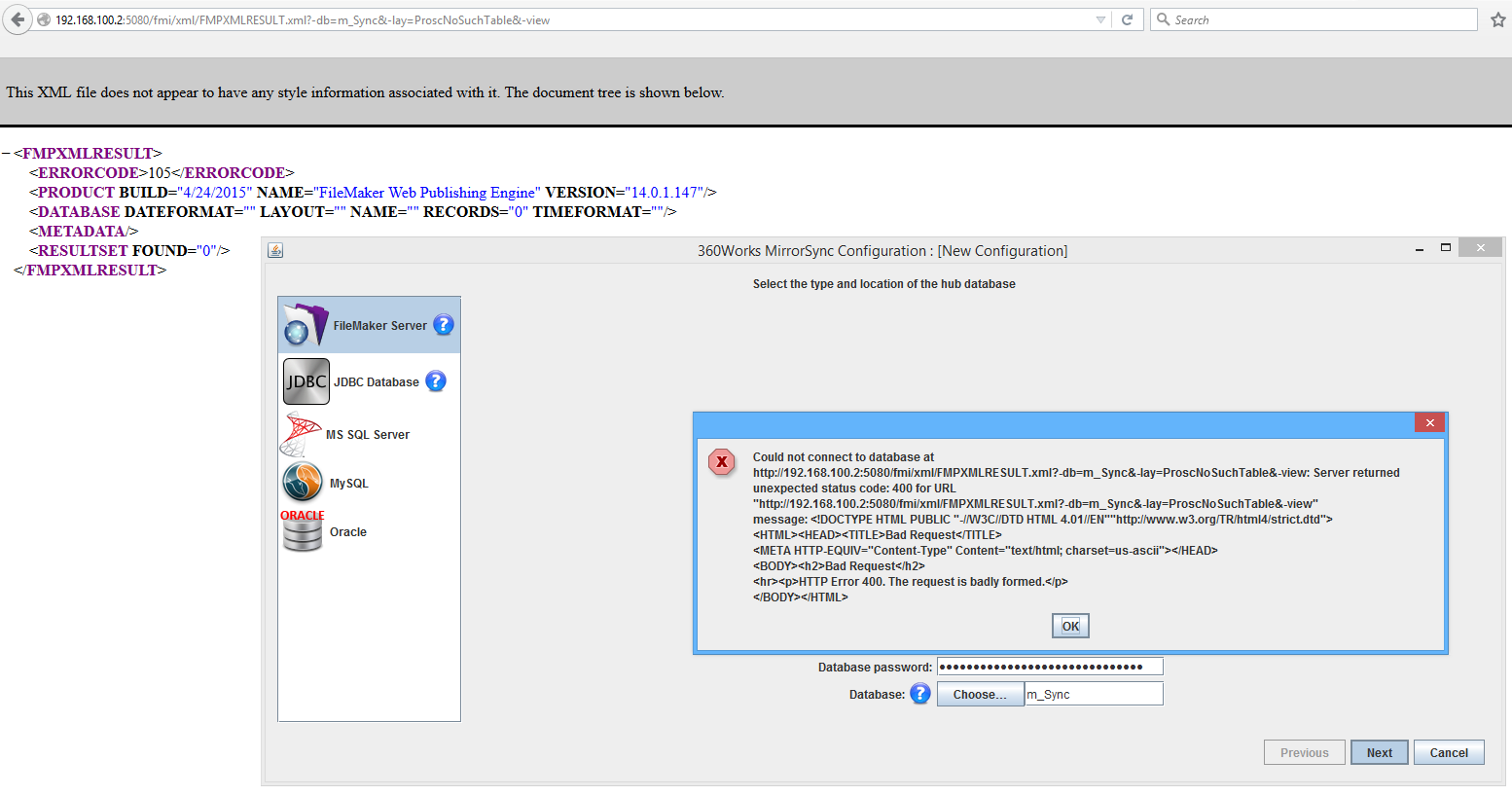

Hi Jesse, thanks for the file. It works differently now, but I got another issue. I'm attaching the screenshot. I've configured FM server to run on port 5080 and specified this on the setup screen. But when I try to get to the next screen, MirrorSync somehow ends up with a completely different response from the server. I've positioned the windows so you can see what it gets and what I get when I access the same address from the browser.
My passwords are not that long (shorter than 76 characters), but they have spaces in them. In the original version this seemed to be the problem, because when I made a provisional login and password without spaces, I was able to progress to the next steps just fine. I didn't complete the setup though because of another issue: this is a multi-file app and the login and password with spaces are shared between multiple files. I only added the short password in the "shell' file that has references to other tables and forgot about other files. As a result when I've set up all the layouts and commanded MS to proceed to the next step (which should produce the sync script), it entered what seemed a neverending loop. (I was able to cancel it.) In the FileMaker log I saw that MirrorSync was denied access to the real files and this probably was the cause of that neverending loop.

- The new version somehow gets a wrong response. Maybe it indeed sends a badly formed request and the gateway (IIS, perhaps) responds with error 400 and doesn't even let it pass to FM.
