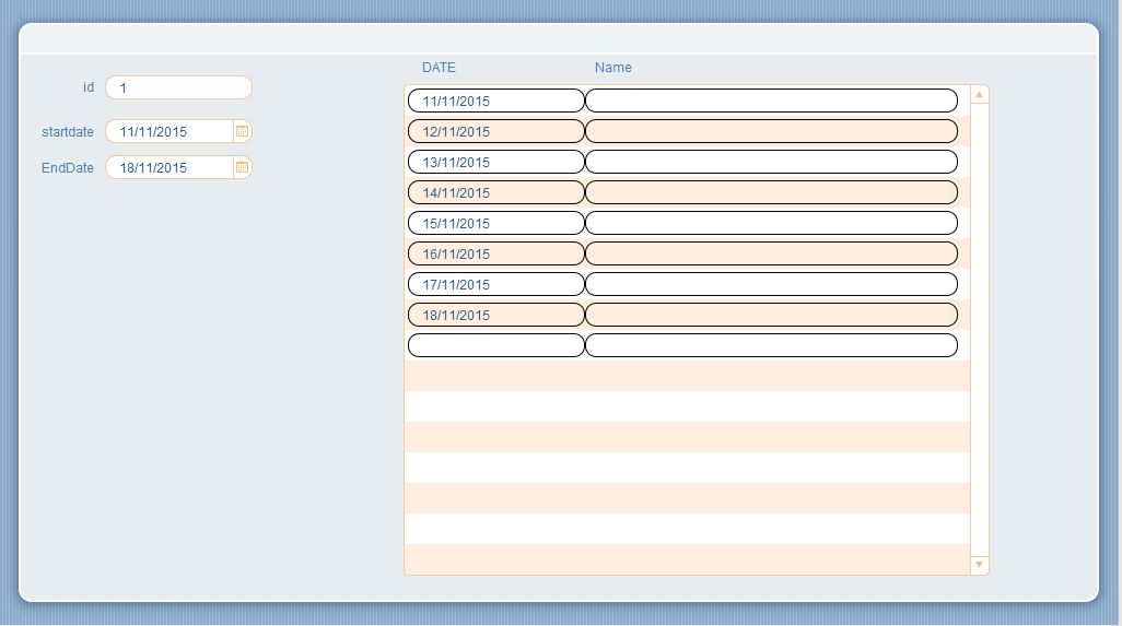

Show a portal of potential entries not yet created based on dates
I have a table showing the following 3 fields
StartDate, EndDate and Location
I would like to show a portal with a line for everyday from StartDate to EndDate. with a field Name (Without creating a child record)
A child record would be created if an entry was added to the field name
Any help would be much appreciated.
That's not possible. A portal displays related records, one record in each row. Without a related record to display, the portal row will be empty.
It is possible, however, to use a dummy table to populate the portal with a "grid" of the required day slots, and to create a record in the real child table when the Name field is filled. See the attached demo file.
DaySlotsGrid.fp7
That will do the trick, neat, like it, thanks a lot.
