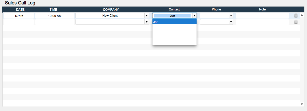

I am trying to create a daily sales call log, for that I have used Portal for which I am using "company" table in which I have "contact 1" to "contact 12" separate fields for each record (company)
Now, on the portal, I was able to fetch contact names dynamically based on chosen company using conditional value list relationship and creating new text field with auto-enter calculation of List(contact1,....,contact12), but how can I fetch contact number for selected contact name for that company? I created a new field to auto-enter calculation of contact numbers like the same way but it seems like I am going in wrong direction

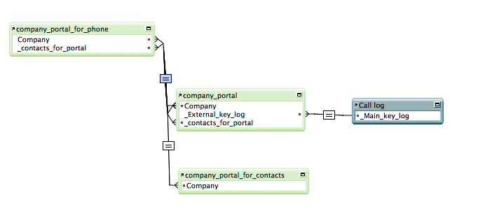

Here is my relationship diagram and layout:
568eaaeddea64_ScreenShot2016-01-07at11.1
568eab89ab058_ScreenShot2016-01-07at11.2

Any time you find yourself numbering fields, like "contact 1", contact 2", etc., you should stop and rethink your design. If a company can have multiple contacts, your solution needs to have a table of Companies and a table of Contacts, with a one-to-many relationship between them (IOW, related by CompanyID).
Once you have this in place, you can select the CompanyID for a call, then select the contact's ID from a value list showing only contacts related to the selected company.

The same thing I want to achieve in Form view with Portal on it, so that I can log daily calls done to any company, each portal record line has contact, number and note on because my goal is to generate monthly report for prospecting calls.

I am kind of confused here because I want a layout with only Portal on which has fields from 3 tables:
- Date, time , Note from Call log table
- Company name from companies table
- Contact Name and Phone number from Contacts table
-- Now if I make layout based on company then each company will have separate portal (which I don't need)
-- If I make layout based on Contacts table, Call Portal will be on each contact record ( Definitely don't need)
-- Layout based on Call log table, I can't put Portal on it based on the same table
So Am I not getting Portal or relationships or both?

So the question is: why do you want a portal? When actually everything you said points to a layout of the Calls table - either in List or in Table view - as the correct solution.

A portal shows related records. You would need a relationship in order to use a portal. As you have explained so well, none of the existing relationships will do - so you would need to define a new, arbitrary relationship. This is possible (with a  few caveats) - but would you really want to complicate your schema just so you can use a portal as a UX element?
It is working fine now.. Thank you so much for your help again @comment
