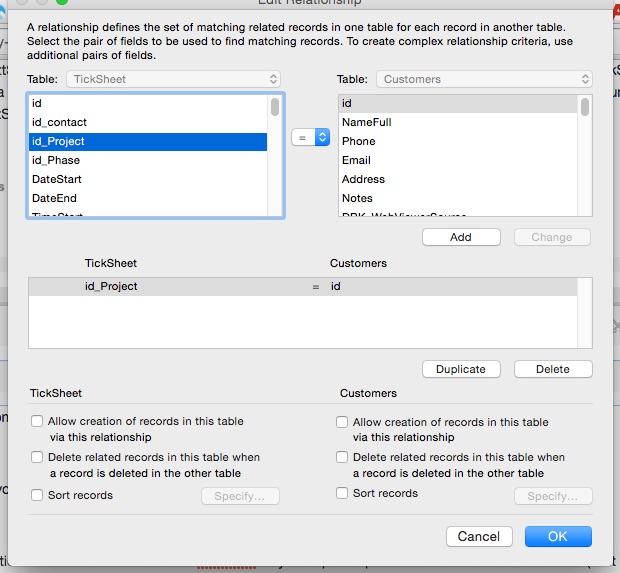

Clients::__kpClientID = Customers::_kfClientID
Customers::ID = TickSheet::ID
What does that mean? One Customer has many TickSheets? Why Isn't it Customers::CustomerID = TickSheet::CustomerID then?

Thanks for replying and apologies, I obviously wasn't clear enough. Please see the attached screenshot.
One Customer has many events in the TickSheet table
The layout is based on the TickSheet table and has a Sub-summary part sorted by Clients::ClientName but I didn't know that I had to add a Calc field to the TickSheet table.
I've done that now and it works perfectly :)
