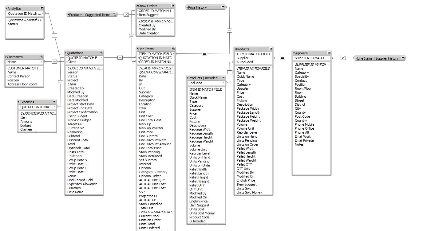

I have a problem with making a filtered value list work. I want to have a drop-down list in one of my portals showing only certain records from a related table, but I can't make it work.
I have (for the purposes of this problem) 3 tables: "Quotations::" "Line Items::" and "Products::". "Line Items::" is the child in both relationships. The table "Products::" contains all of our stock, not all of which is for sale, so I would like to have a check-box field that allows me to include the item or not in the value list of sellable items.

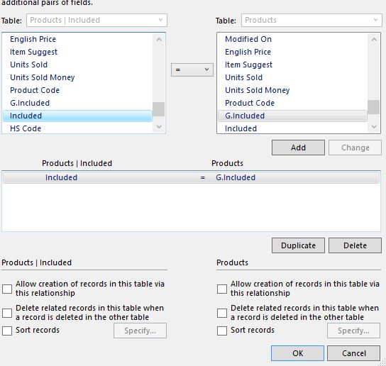

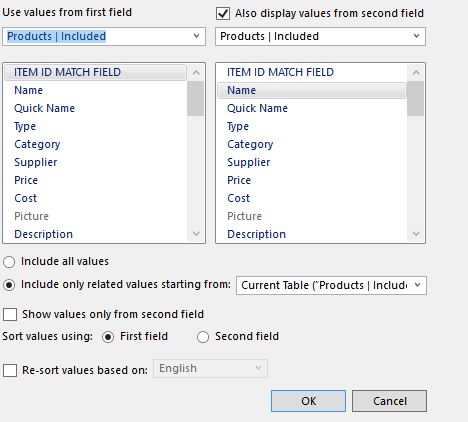

From what I read on the forums here, the way to do this is to create a second occurrence of "Products::" and relate it to the first. I created a global field called "g.Included" and created "Products::g.included" and related it to "Products | Included::Included". I then made a value list showing "Products | Included::Item ID match" and "Products | Included::Item". If I don't check "Include only related values starting from: Products | Included" it doesn't filter and if I do, it only shows the active value and doesn't let me chose anything in a normal layout and in a portal it says <unrelated table>
What am I doing wrong?
Many thanks in advance

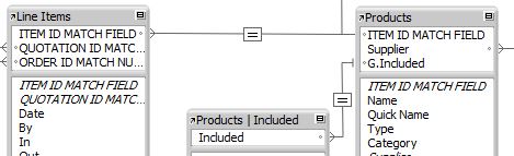

The problem with your approach is that the "Products | Included" TO is not related to "Line Items" until you have selected a "ITEM ID" value in "Line Items" - which kinda defeats the purpose here.
To make it work the way you have started, you must place the  global field in the "Line Items" table, and relate the "Products | Included" TO to it directly. Then define the value list to include related records from "Products | Included", starting from "Line Items".
