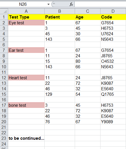

In one table should be defined for each test, which patients have been examined. (plz see patients and tests pic).

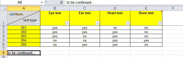

In another hand, different combinations of "done or not-done tests", make different type of Lists (list num 1, list num 2,.....). Therefore I should create a seperate table for keeping these infos.  (plz see test and lists pic).

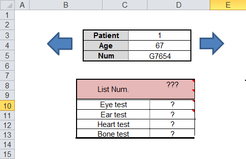

Finally I need a table ( layout) somehow as a combination of 2 previous tables.   (plz see connection pic).
In this table for each patient,  should be automatically defined whether this patient has done these tests or not. (with help of patients and tests table)
After that according to the combination of the tests that this paitient has or has not done, should the list number automatically be identified .(with help of  test and lists table ).

No, patients do not have to do all tests. I understad what you said, but actually we have a excell sheet (the same as "patients and tests pic" I attached) and it shows for each test, which patients have been examined and I thought maybe it is possible to do somehow a "reverse search" and find that which tests have been done by each patient!

From what you have told us, it seems you only need two tables: Patients and Tests, related by PatientID (in other words, a one-to-many relationship, whereby one patient has many tests). You will also need a value list of TestTypes (which technically should be another table - but since it doesn't seem like you have anything to record about a test type other than its name, a value list should do).
In the Tests table, other than PatientID and TestType, you will also need a field to record the fact that the test has actually been performed. This could be a date field, for example, or even a number field with 1 entered into it when a test is done (although a date field is preferable for keeping a trail).
That would be about all that's required in terms of data structure.
In terms of display, you can produce a report of the Tests table, summarized by TestType, to show a list similar to your 1st picture. A form view of the Patients table, with a portal to Tests, will look very similar to your 3rd picture.
Producing a tabular display like the one shown in your 2nd picture is not easy. In fact, it's not possible to have such display, unless the number of columns (i.e. test types) is fixed. However, you can very easily produce a report of tests, summarized by patient, showing the same information in vertical direction.
