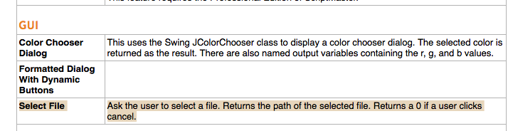

You should use the ScriptMaster SELECTFILE Function:
The 360Works instructions are complete but can seem obtuse at times.  Just watch the video and 'mess with it'
until it works.
