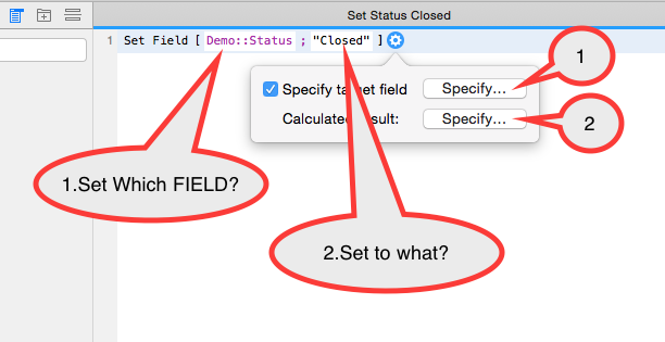

This is all about learning how to properly use the Set Field script step; and the various parts of this script step.
See attached screen shot and modified file.
DemoMOD.fmp12
Much better, and much appreciated!  It has been years since I have touched Filemaker and I knew that I was missing something - I was trying to both select the field and set the value from the calculate step rather than two separate ones.
