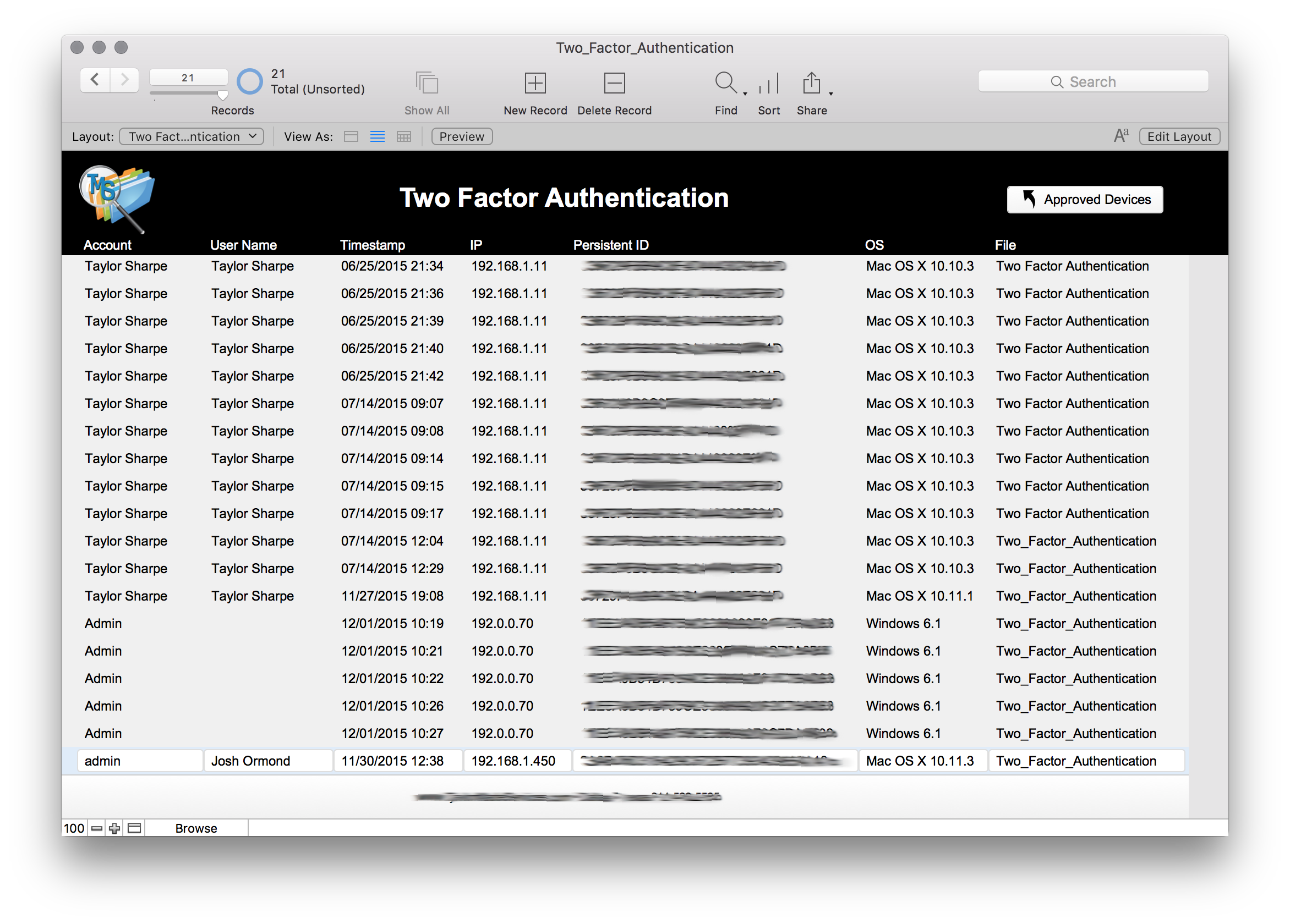

November 30, 2015 at 12:40 PM by Josh Ormond
Dangerous. You are going to owe me $200. Note, not only did I get in, I authorized myself for future log-ins, and altered other data. And if I wanted to be nasty, I can lock everyone out by hosing the PersistentID.
Did you want to see the Device Access also?
2FA001.thumb.png.cd289977f3155ecbed242f5

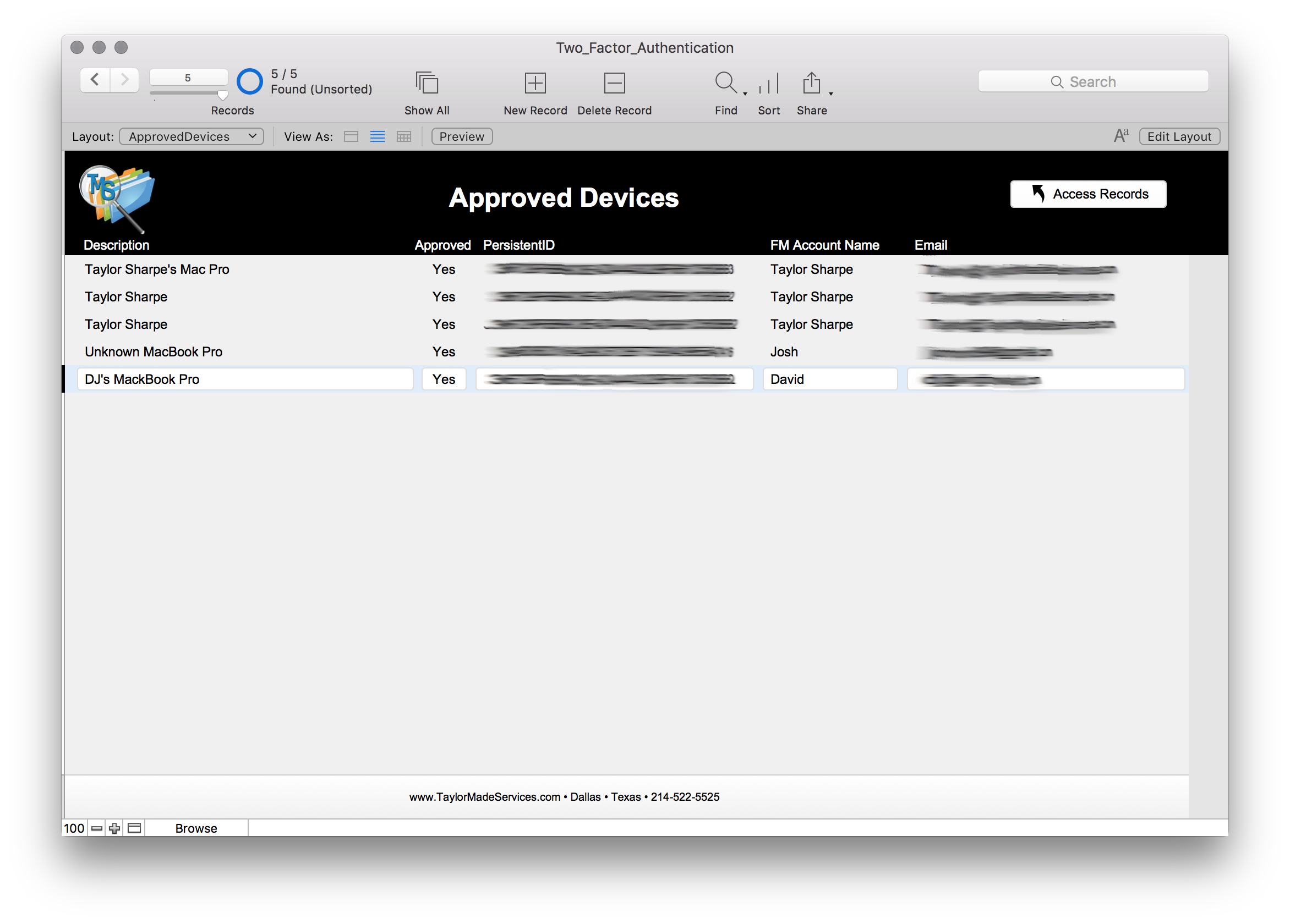

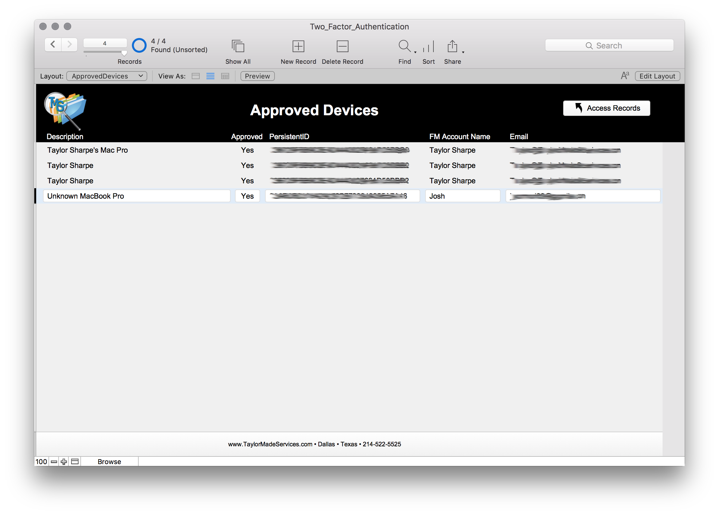

November 30, 2015 at 12:43 PM by Josh Ormond
Here are the approved devices also. Note in both of these screen shots, the Persistent ID isn't not even the one from my machine..it still lets me in.
2FA002.thumb.png.d2d5f31efa219a0aba5be3b

November 30, 2015 at 11:04 PM by David Jondreau
I have some warnings to give, but am not going to post publicly. I'm trying to send a private message, but it's not going through. I'll try again after posting this...
Taylor, you've made some changes to the server since this afternoon. That's the first step.
To answer the original challenge:
The easiest answer is simply to use ExecuteSQL() in the data viewer. Using one statement to grab the table schema, and another to grab all the values. Even with the custom dialog, the data will show up on hover.
https://community.filemaker.com/servlet/JiveServlet/downloadImage/105-9612- 19278/Screen+Shot+2015-11-30+at+1.51.48+PM.png <image lost>

December 1, 2015 at 12:23 AM by Taylor Sharpe
David Jondreau wrote: “Taylor, you've made some changes to the server since this afternoon. That's the first step.”
https://community.filemaker.com/servlet/JiveServlet/downloadImage/105-9602- 19267/Screen+Shot+2015-11-30+at+1.51.48+PM.png <image lost>
The only change I made was with the easy way you can use a TO in another solution to see data in the original solution if you have the same User ID/password and that had already been provided. So all we did was change the File Access security so you can't add a table from another solution without Full Access.
David... good example of how ExecuteSQL can be used to view things in the data viewer and it does give you access to schema. That lets you read data, but doesn't let you change it and not sure how this would be used to stop the Persistent ID verification. But clearly that is something that in the security world you don't want done.
I guess this is why Tim Dietrich's system had an intermediary user ID log in for the Persistent ID verification and that User ID had very limited table access and only to verify the Persistent ID and connect with a User and their Email. You would be in the solution as Wim notes, but not at your normal User ID access level. And upon verification, have a re-login with your normal User credentials. And that would be a better solution.
Thanks for the thoughtful input.
December 1, 2015 at 1:03 AM by David Jondreau
Hmmm...You've made other changes to your server. Not to that file per se...but I'll save that for a private message.
Point is I can see all the data that user has access to. I can't change it. But I can easily view any data. And that took less than a minute.
There are other points about how to change data that I'll put in a private message as well.
2FA003.thumb.png.881563c7ad30da26ec9d424
December 1, 2015 at 2:51 AM by David Jondreau
And here's my entry...
2FA004.thumb.png.040856ab262c653fc9219bc
December 1, 2015 at 9:06 AM by Taylor Sharpe
Impressive David to see the Persistent ID script hack. I'm more interested in this hack than the File Access one since I already knew about it. But you got through with File Access turned off. Kudos.
