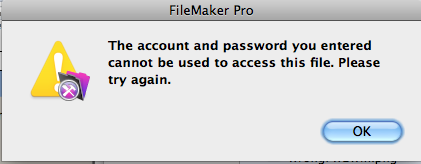

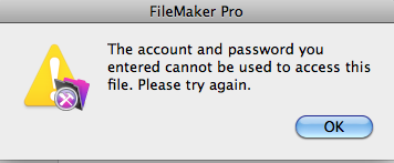

In such an attack a Threat Agent might trick a user into believing that he or she had entered credentials incorrectly, most likely due to a mistyping.  Such so-called “fat-finger” errors occur all the time. FileMaker Pro presents the user with a dialog box advising of the error, and it asks the user to please try again.
The user then clicks the OK button and enters the credentials again. This time, the credentials work, and the user proceeds to go about his or her business in the file.
But there was no credentials failure the first time around.  The user had entered the correct credentials. One of these dialogs is real; the other is not, and it is the beginning of a phishing attack. The purpose is to trick the user into entering the credentials a second time, so that they may be captured in clear text and later used for nefarious purposes.

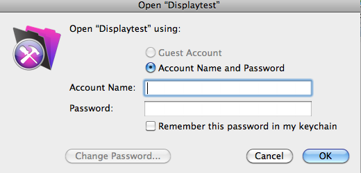

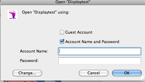

That subsequent credentials entry box as shown below is a bit harder to spoof than is the error message.  But when an Attacker can do that, this exploit likely will trick many users and possibly even some developers. Remember, it does not have to be perfect.  It only has to be good enough to trick the user.
