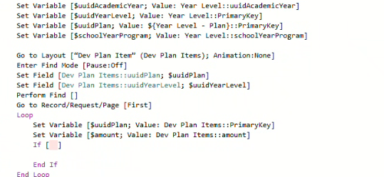

Hello Guys, Can you help me? i am a beginner in filemaker and this is the script i created, i have a script step that finds a multiple record and if found, next step is looping, to compare the value of amount field from one table to another. If it not equal it will update the value. hope you understand guys. thanks

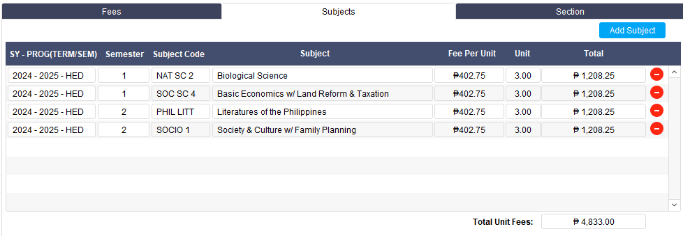

Hello everyone, I am just a beginner, can you help me? In this image, I have the same field for the subject but they are in different semesters. What I want to achieve is to get the total amount of the subject per semester separately, even though they are in the same field. For example: Total amount of the subject for Semester 1 Total amount of the subject for Semester 2 I don't know if this can be done through calculation or a script. Thank you.

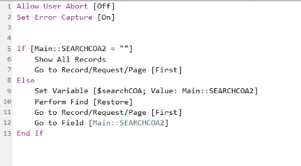

Here is my table that i want to create a search function. I have a variable field in Main table. and also here is my script. But it is not working. When I search for any text that isn't in the portal, the portal empties. However, when I search for a specific account name, it doesn't appear. What could possibly be wrong with my work here?
how to create a script that finds or search a record in a portal?

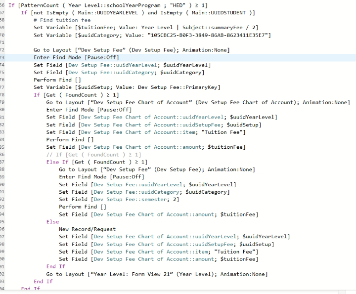

Here are my script, but i cant set an amount in second (2) sem. Maybe i am wrong for finding the field for 2nd sem in Else If step that is why it did'nt work Here
I want to create a script that finds a category "Tuition Fee" in a portal and then when i add a subject the summary amount of added subjects will divide into two (2) and then set to the two "Tuition Fee" fields. What i mean is the divided amount will set to the two fields also named "Tuition Fee"

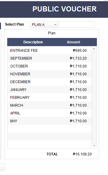

Let me revise and clarify my situation. Total School Fees = 16,108.20 Enrollment Fee = 695 Scholarship = 9,050 Total = 6,363.2 The total will be divided by 9 6,363.2 / 9 = 707.02 SEPTEMBER = 707.02 OCTOBER = 707.02 NOVEMBER = 707.02 DECEMBER = 707.02 JANUARY = 707.02 FEBRUARY = 707.02 MARCH = 707.02 APRIL = 707.02 MAY = 707.02 The amount of month October to May should be exact 700 only. So, what i want to happen is the excess amount from month of October to May is will always be added to the first month, which is September. What calculation or function in FileMaker should I use to achieve this process? -
