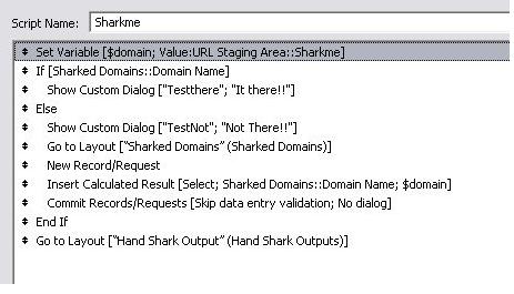

LaRetta, I downloaded your test2, and it worked just as you said, only weird part was if I used text would get "No" in calc, if I used number that was in the second table i would get "Yes". If I used a number that was not in the second table, I would get "" nothing. The script side reported all. Ok, Now for my script... After seeing the results of your tests, I when back and examined it closer and found that the couple of domain tests I used happen to have at least 1 number somewhere in the domain name. when I tried straight text, always false... great.. back to the drawing board!! LaRetta, I tried the [not IsEmpty ( Sharked Domains::Domain Name )] and seems to work correctly under numerical/text/mixed...lol Thank you for saving me a huge headache!! And sorry about the one I gave everyone else! -

Am I missing something, because in my tests, it's doing exacts matches.. if I change one letter or number in the comparison, it sees the difference and reports correctly. -

LaRetta, I tested it against both ip and text domain, seems to work fine both ways. Here is how I set up my test: -

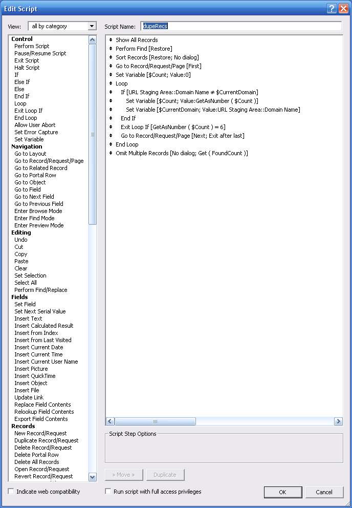

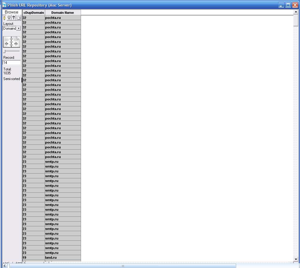

Making Progress, Here is what I have done; Created following Fields: Created a Self Join relationship "URL Staging Area::Domain Name" cDupDomain = Calc, Unstored, From URL Staging Area, = Sum (Domain Dupes::One) One = Calc, from URL Staging Area, = 1 SumOne = Summary = Total of One I will just attach jpg's of both the scripts and result. Just want one of each record to display, and would like to have in a portal. If this sounds incohent.. due to major lack of sleep..
