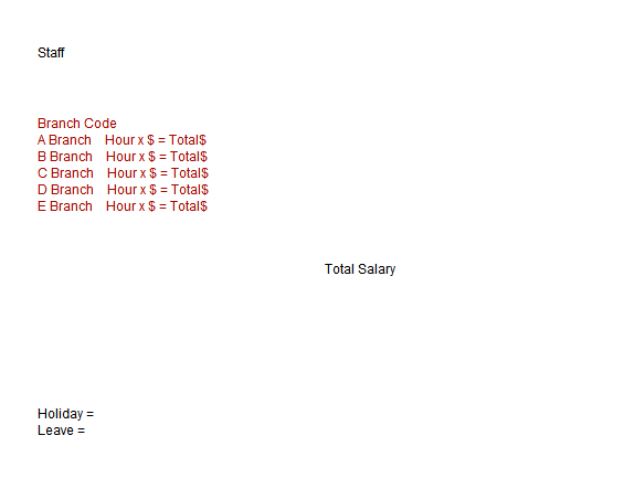

I want to make a report like as attachment.
how to group the branch code and calculate the hour & $. Thanks for your help.

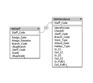

Your question is not clear. Do you want your report to be summarized by Staff, then by Branch_Code? If so, why is there a Branch_Code field in your Staff table, too?
Also please explain what fields do you have, and in which table, from which one would calculate the hours and the $.
Thanks for your kind attention.

Report
A111
Branch
COD <sum COD working_hour> x hour salary $ = COD salary$
ABA <sum ABA working_hour> x hour salary $ = ABA salary$
EXE <sum EXE working_hour> x hour salary $ = EXE salary$
  Total Salary = COD$ + ABA$ + EXE$
Thanks a lot
The fields that you need to have in the Attendance table:
• StaffID
• Branch_Code
• Hours_Worked (Number)
• Hourly_Rate (Number)
• cWage (Calculation = Hours_Worked * Hourly_Rate)
• sTotal_Hours (Summary, Total of HoursWorked)
• sTotal_Wage (Summary, Total of cWage)
Once you have that in place, produce your report using a layout of the Attendance table, with three sub-summary parts:
  1. a leading sub-summary when sorted by StaffID;
  2. a leading sub-summary when sorted by Branch_Code;
  3. a trailing sub-summary when sorted by StaffID;
and no body part.
Place the staff name field/s from the Staff table In the leading sub-summary by StaffID part.
Place the Branch_Code, sTotal_Hours and sTotal_Wage in the sub-summary by Branch_Code part.
Place the sTotal_Wage field in the trailing sub-summary by StaffID part.
