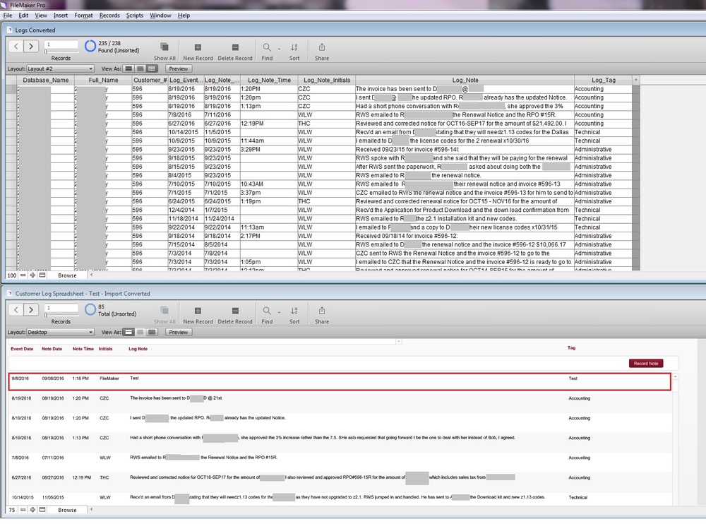

I'm very new to FileMaker design, so I may be missing something very basic, but I cannot figure out how to make this work.  I've got a working portal set up, showing the correct records.  I can add new records using the blank line in the portal, and those records then show in the portal window.  However, if I go look at the actual table that the portal links to, the new records are not being added there.  Are they going somewhere else instead? I need to actually create new records, not just display them!

Perhaps they are just omitted from the current found set in that layout? I cannot figure out what your screenshots are supposed to show.

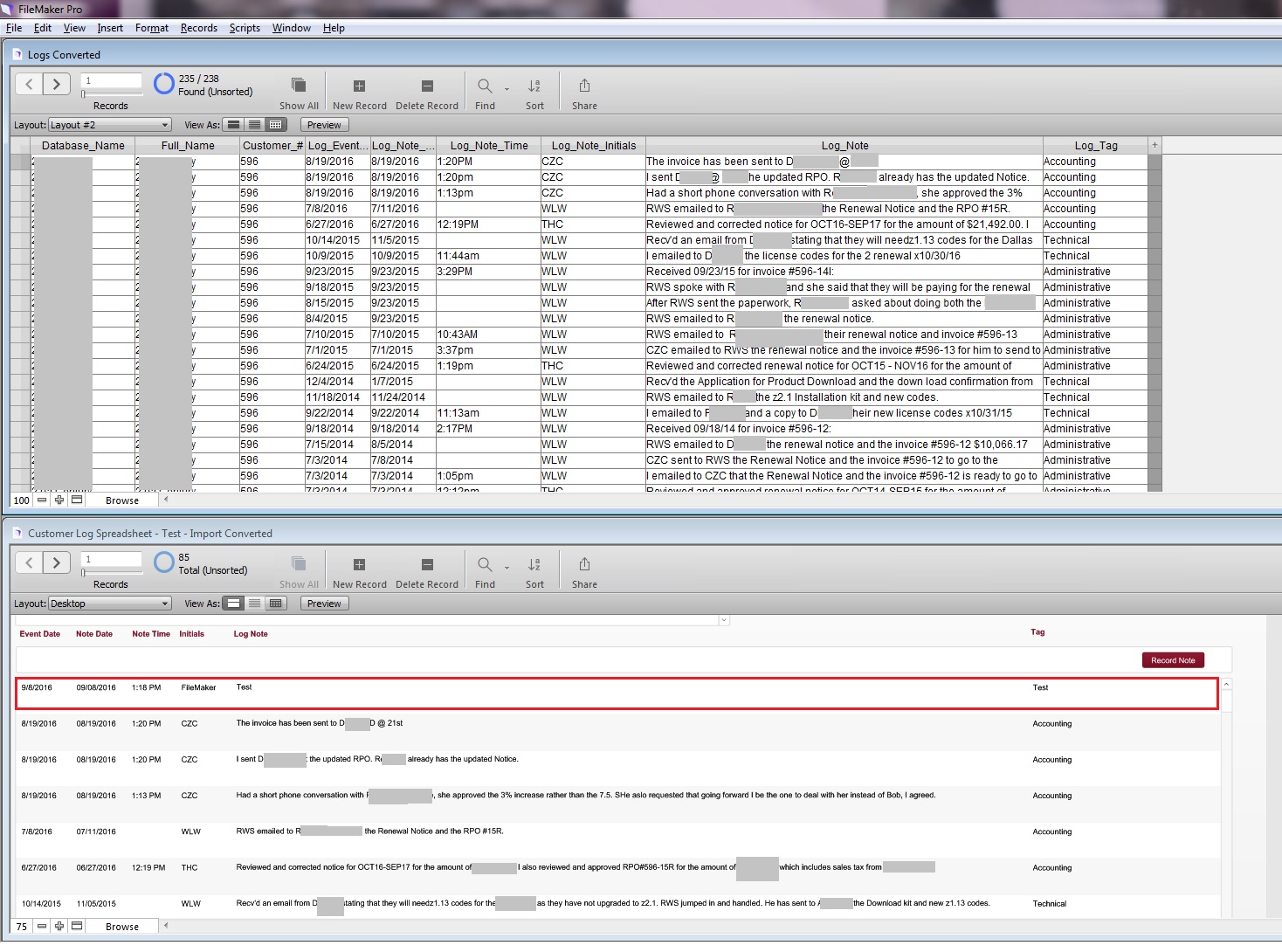

The screenshot is showing the portal in my primary layout view on the bottom, and the linked table opened in a separate view on the top.  The new record I created within the portal is circled in red; it has not been created in the linked table.  I haven't limited the table view by searching, and I've tested exporting that table and checking to see if it's in the export; it is not.

The top screenshot shows that 235 records are found, out of 238 records in total. So you have 3 omitted records that are not shown.
