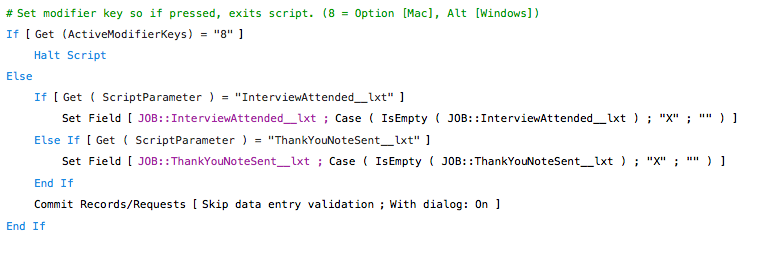

Greets all:
I've read the FileMaker Help on this (http://www.filemaker.com/help/13/fmp/en/html/scripts_ref1.36.43.html) as well as some of the threads here and I just can't wrap my head around how to implement the Set Field by Name for a short script...assuming that's the correct command to use, of course.
I've attached a screenshot of what I've done so far just so you can get an idea of what I want to do: For any field that has a On Object Enter script trigger attached, what I want to happen is that when a user clicks in that field it will toggle the result; if that field is empty the script will insert an "X" into the field; if it already has an "X", then it will clear it.  (As you can surmise, I'm using these as checkbox fields without having to assign the Control Style as a checkbox field.)
You may be wondering about the ActiveModifierKey part: Because the script trigger will fire automatically when a user mouse clicks a field, I need a way to halt the script so if the user wants to change a found set's values from say, "X" to "empty", holding down the Option/Alt key will all him/her to manually clear the field then use the Records > Replace Field Contents command to clear the fields. (If you can think of a more elegant solution of doing this I'm all eyes!)
TIA for your help!
(...and yes, I know Dialog should be off in the Commit Records step.)

Thanks for the link! I incorporated the script that was in the comments and have attached the file for anybody that's interested. Holding down the SHIFT key will halt the script trigger-fired script so you can enter/remove the value to allow for Replace Field Contents.
Toggle.fmp12
Great. That always shows you how to abstract a script so that it can function from any context given the correctly passed parameters.
Why did you opt for a text value rather than 1? I prefer my boolean fields to be 1 or 0 (or 1 and null).
Then, all you'd need is [Set Field by Name (myfield) ; not myfield )]
I'm sure it's my ignorance or incompetence showing, but because I wanted to have an "X" for a checkbox character instead of a non-intuitive "1" for end-users; looking at your very elegant calculation, I couldn't figure out how to make it work for a non-Boolean character. I tried fiddling around a little bit in the Inspector by setting the Data Formatting > Format > Boolean > Show Non-Zero to "X", but when in Find mode and clicking in the so-assigned field, a "1" would appear; that would stymie end-users.
