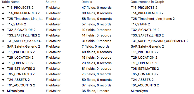

When i deleted all the records in the new duplicate file, i also reset all the serial numbers back to default on every table but the one table i was keeping populated (products has 12000 records and images so this is what i wish to ship out with the data already intact). I had some major issues doing this with a new configuration, so i ended up doing a new configuration synching to the same file in order to be able to finish the configuration. I than went back and hit edit the config so that I could select 'sync with a separate mobile file' (remember it wouldn't let me go any further by selecting this as default). I managed to get all the way to the end, jumping between files first the desktop version, and than to the duplicate file.
Last step it was asking me to past tables into my duplicate file and to copy the script step into the duplicate. I could get a green check mark for the script steps, but i could not get the paste tables to achieve a green check mark (it remained with a triangle). The tables that where being pasted in made no sense (please see attached photo) and because i could not get it to give me a green check mark i hit finish anyways. On sync everything looks okay (except some conditional formatting that used primary keys that are now mirror sync managed and not the same value), and these new pasted tables remain at a zero records and never used. Not sure what to think about that.
Tables are sorted by creation date, so you can see that after pasting in the mirror sync table, that I ended up pasting the other tables above it

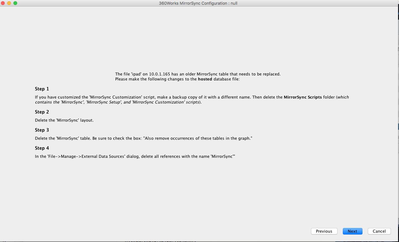

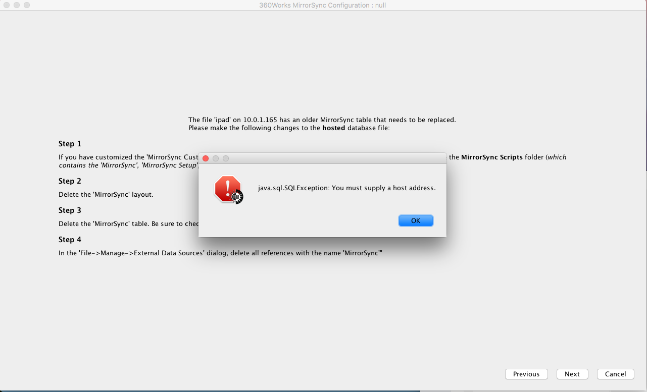

this is the window i get.
Interesting enough is that none of those items exist on my iPad configuration. I purposely deleted them earlier on
and if you hit next to skip past that

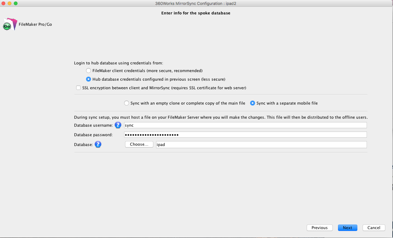

so to finish the sync setup you need to not select "sync with a separate mobile file" but instead go through like a normal setup
So than I click edit on the config engine and proceed to walk through to make the change to a separate mobile file

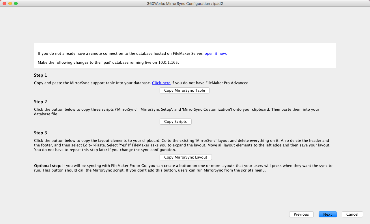

when you hit next your are presented with this screen

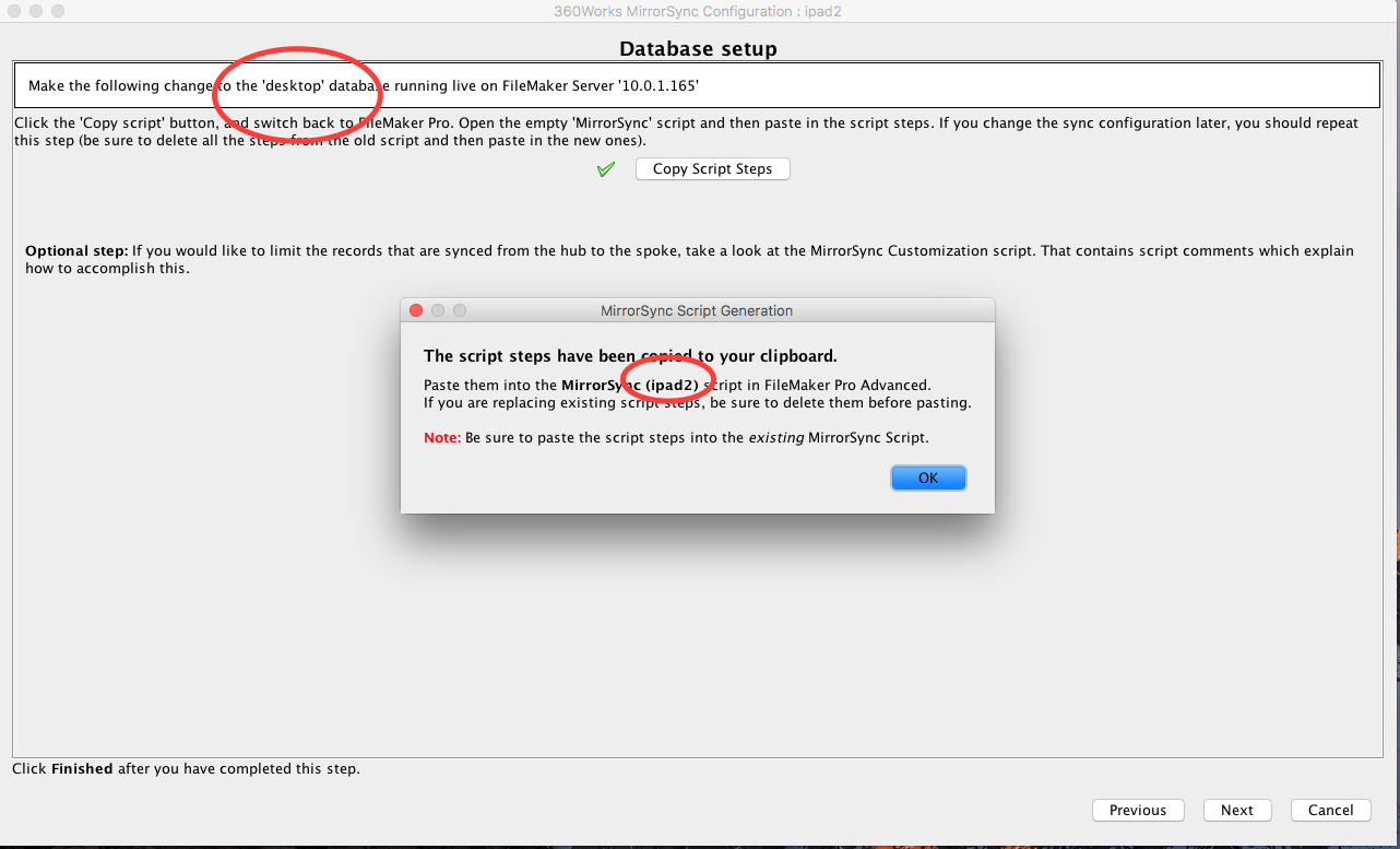

i was presented with this option to past the script steps into a file. but what file as i am given misleading information -- i am going to assume the iPad copy
and i haven't pasted anything yet so why is it checked Green?

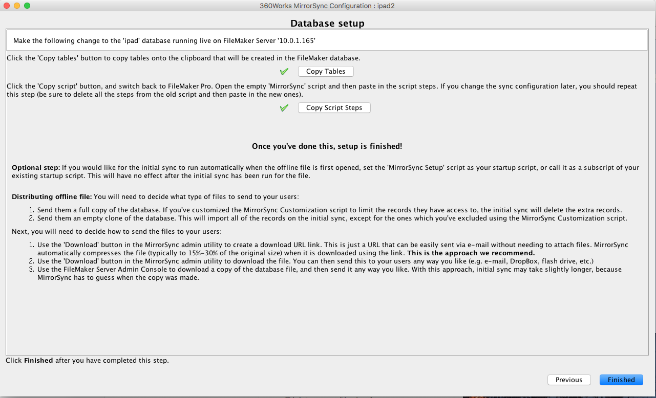

when you hit next again this is the new screen
again, I haven't pasted anything yet,
What tables are we talking about, is this the crazy ones that i mentioned earlier on ?
