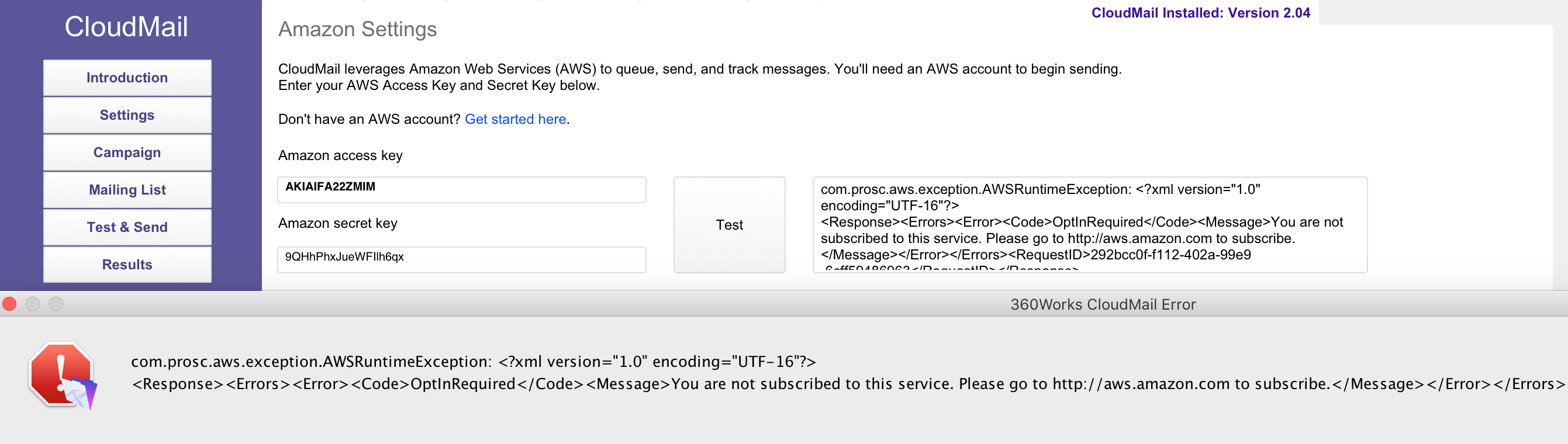

Hi everyone,
I have generated my keys :
          - Amazon access key
          - Amazon secret key
Run TEST...
         ...The following error appears
<Error><Code>OptInRequired</Code><Message>You are not subscribed to this service. Please go to http://aws.amazon.com to subscribe.</Message></Error>
view image attach
To what service should I subscribe?
regards
rodeand
Can you confirm that those are the correct access key and secret key? The secret key looks a bit shorter than most I've seen. Possibly a '/' that prevented copying the full key.
Hi,...
The keys are correct, ... I shorten them (for the image)
regards
Rodland
The only reason I mention it is that it seems to be related to the account not existing or being fully activated. That is an error we get back from AWS. If you go in to your AWS console can you create an EC2 instance?
