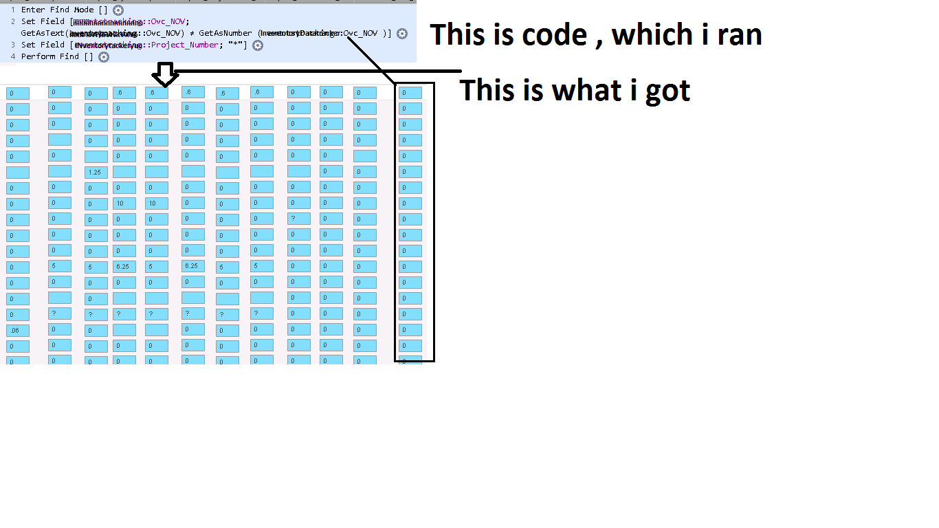

I have attached screenshot where i mentioned, How i coded that find condition and what i got as result. please see that.
This is very different from what I suggested:
On 03/23/2017 at 10:53 AM, comment said:
You would have to construct a calculation field along the lines of =
GetAsText ( YourFirstField ) ≠ GetAsNumber ( YourFirstField )
and search for 1 in this field.
OK but as fields are 90 so not good choice. But yes if fields are less then it is wise decision.
