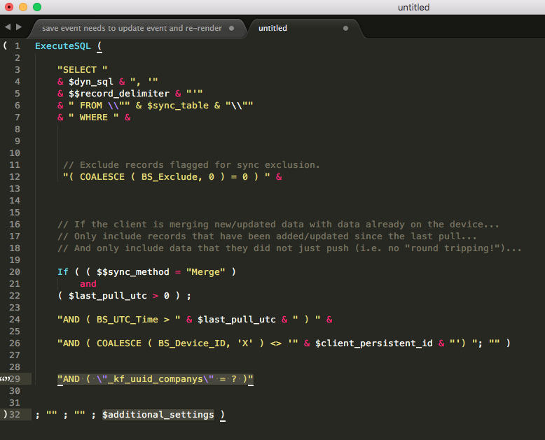

I am looking to add a line into the following code into the 'prepare payload for client' section to select only records that match the following criteria
  • I have a variable set called: $additional_settings
  • The field that needs to match with $additional_settings is called _kf_uuid_companys
the code that i have already is as follows, i need to add a line into this code to pick records where the field _kf_uuid_companys matches $additional Settings.
Any help would be greatly appreciated:
"SELECT "
& $dyn_sql & ", '"
& $$record_delimiter & "'"
& " FROM \\"" & $sync_table & "\\""
& " WHERE " &
// Exclude records flagged for sync exclusion.
"( COALESCE ( BS_Exclude, 0 ) = 0 ) " &
// If the client is merging new/updated data with data already on the device...
// Only include records that have been added/updated since the last pull...
// And only include data that they did not just push (i.e. no "round tripping!")...
If ( ( $$sync_method = "Merge" )
and
( $last_pull_utc > 0 ) ;
"AND ( BS_UTC_Time > " & $last_pull_utc & " ) " &
"AND ( COALESCE ( BS_Device_ID, 'X' ) <> '" & $client_persistent_id & "') "; "" )
Hey, try adding this line (including the quotation marks) at the end of your SQL statement: "AND ( \"_kf_uuid_companys\" = ? )" Please note the \" around the field name--You'll need these since your field starts with _. Then include $additional_settings as the argument in your ExecuteSQL calculation like so (See attached image).
Alternatively you can embed the variable right in the SQL text: "AND ( \"_kf_uuid_companys\" = '" & $additional_settings & "' )"

P.S. This doesn't matter at all, but I believe it's spelled companies. ;)
