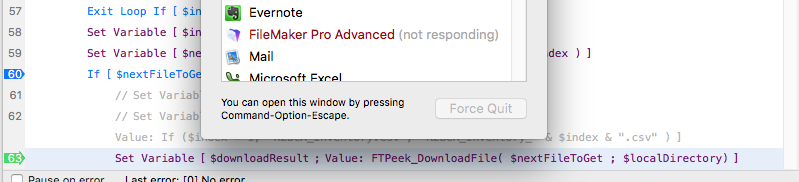

The plugin crashes Filemaker Pro Advanced, v15.0.3, when I execute FTPeek_DownloadFile(). The file actually does download. Next step is the error script and that never reports. Filemaker just beach-balls.
Running Mac El Cap 10.11.6.; 16gb RAM.
Not yet on server; just testing in development.

I have seen an issue similar to this and the problem was being caused by the progress bars. Add FTPeek_SetShowProgress(0) to your script before the download function call to suppress the progress bar and see if that resolves the issue.
Ryan,
That worked. Thanks.
