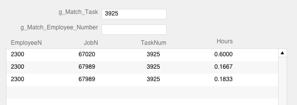

3 key relationship: minimal (incorrect) return.
2 key relationship: minimal but DIFFERENT (incorrect) return.
1 key relationship: minimal but DIFFERENT (incorrect) return.
Testing DIFFERENT SINGLE KEYS no joy.
Always a maximum of 3 records returned.
I am now noticing one other large record count table that has the same problem.
Edited by CoZiMan
Could it be that you are using the trial version of the ODBC drivers?  Those always limit the return to 3 records I believe.
Wim, I made sure I have the paid version. Re-added the user and system dsn.
When I add that table and go to view after three records I get timeouts and no data.
