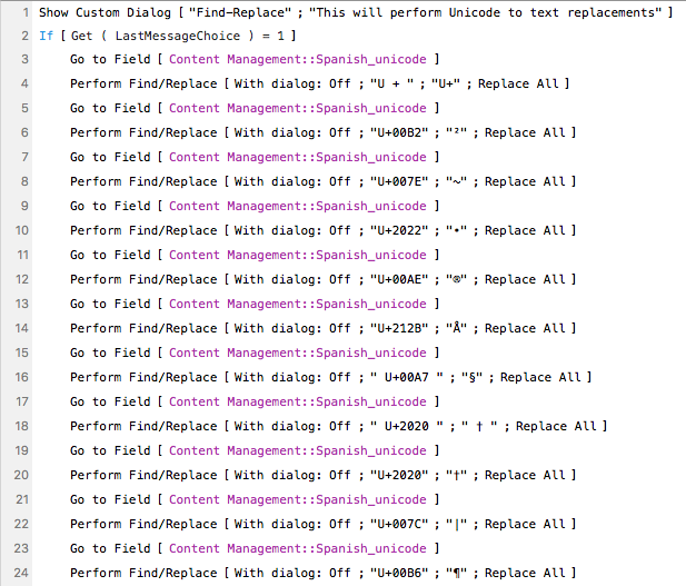

June 4, 20179 yr Hi, I'm writing a find-replace script to change special characters to Unicode code and another script to change them back to special characters (see screenshot). It seems I should be able to assign the "Go to Field" once and run ~1000 Find/Replace(ments) in one go. I'm not going to switch to another Field during this process. Is the Script Workspace the right way to do this or would it make sense to have the Find/Replace units in another .fmp12 file? Best, Daniel
June 4, 20179 yr Is there a reason why you cannot use the Substitute() function within a single Set Field (or Replace Field Contents, if you're handling multiple records) script step? A single instance of Substitute() can contain up to 999 search/replace pairs, and you can nest multiple instances if you need more. BTW, if you have a "map" of search/replace pairs that you need to use in both directions, you might consider storing it in a table or hard-coding it to variable/s. Then use a looping script to perform the substitutions. This would be useful if the "map" ever needs to be changed, as it would only require one change for both directions. Edited June 4, 20179 yr by comment
July 17, 20179 yr Author Thank you for the suggestion. I migrated the Script replacements to a calculation field using Substitute and it's working fine. It's also blazingly fast. Best, Daniel
