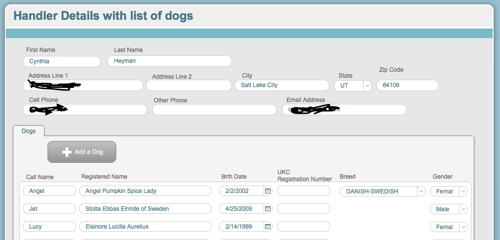

I have a layout where it shows a Person's information (name address etc), and it includes a Tab Control that lists all the dogs that are related to (owned by ) that particular person.

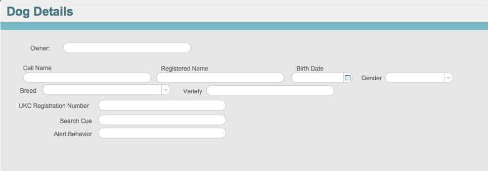

I want to be able to click on a button that allows the user to add a new dog that is connected to the person showing. I have a Dog Details layout, I just need to pass the person key/information to the Dog Details layout so the dog is automatically added to that person.
I've attached a screenshot of the Person Details layout with the Tab Control, and the Dog Details layout, where I'd like to have the Owner field automatically filled in when added a new dog.

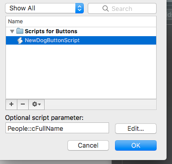

In my button control, I've tried a Single Step and the Go To Layout, and adding the Optional Script Paramater, using the Primary Key from the People Table, but it doesn't seem to be working.

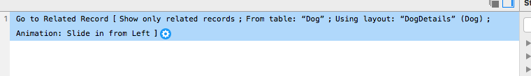

I've been able to pass the record to the Dog Details Layout... but it passes everything, and I only want the Person passed, not the dog information.
