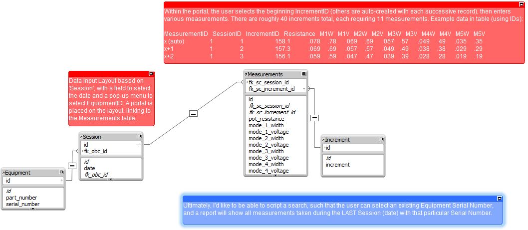

In a nutshell, I am taking measurements on a piece of equipment. I am recording the equipment serial number, date, the increment being measured (about 50 different values, from a value list based on a table), then 10 measurements for each increment. To avoid having the date and equipment serial number stored 500 times for each 'measurement session', I have those items split apart into separate tables, then all of the measurements stored in a junction table (see attached, items are renamed a bit to prevent interfering with actual database tables):
I have a report based on the junction table (blue above) and it simply lists all values in the table. The user can search for a particular equipment serial number, but this returns all values related to that serial number (and all of the dates that measurements were taken). Certainly, the user COULD search for the particular equipment desired, then view the available dates, the modify the find to only return those dates. However, I was hoping to somehow script this action, such that the user could simply select the equipment serial number, and only the last 'session' measurements would be returned (the most recent date) automatically, as those are the only pertinent values.

Hmm... I think the part that is tripping me up is that a user would ideally search for the serial number first, but from what I've read on related searches, the report has to be based on the most 'child' table (which I assume, in my case, to be the table with all of the actual measurements listed). I think that the design of the tables themselves might not be helping me, but it seemed like the most logical (to avoid repeating data, space considerations, etc.), considering that the equipment serial number isn't located in the most child table.
The increment is literally an 'increment'. So, when the measurements are done, date and equipment serial number are recorded, and the observer sets an adjustment (ranging from .5 to 2.5, in .05 increments) then there are 10 measurements recorded for each increment (e.g. set adjustment for .50, measurements 1 through 10; set .55, measurements 1 through 10; set adjustment to .60, measurements 1 through 10, etc.).
Initially, everything was jammed into one table. So the date and equipment serial number were repeated hundreds of time, for one measurement 'session'. It just didn't seem right.
