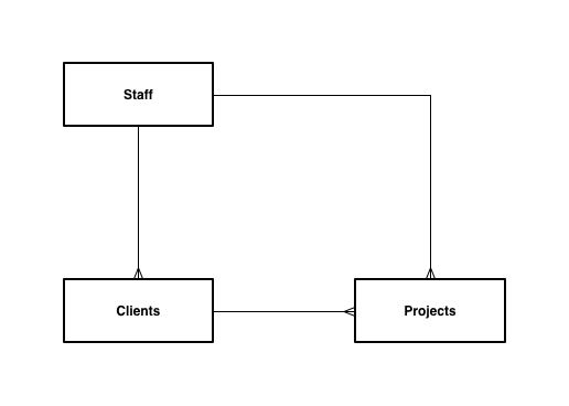

There are (at least) two things I did not get from your description:
2 hours ago, Ben ECA said:
A client must have one, only one, staff (caseworker). a client's caseworker may change later
Do you need to keep a history of these assignments?
  • A project must always have a client and a project caseworker
Can a project have more than one caseworker?
Thanks comment
A history of the assignments would be a good addition, actually.
No, a project can only have one caseworker. If any other staff were involved, it would be as a resource in tasks under that project. The idea of caseworker is that they teke responsibility for the project, so only one caseworker per project. The caseworker could change during a project, but not usually.
Well, think about whether you need it - because it will add complexity to your solution. Without it, all your relationships are one-to-many, so I don't see why you would need any join tables. Here's an ERD that I believe summarizes everything you said in your original description:

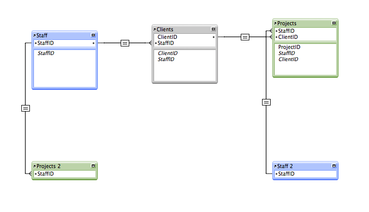

4 hours ago, Ben ECA said:
how would I go about actually creating the relationship?
That depends on your intended workflow as well as on your personal preferences for organizing the relationship graph. Here's one way it could look:
where the Staff 2 TO is meant to be used for viewing the details of the selected project manager, and Projects 2 can show all of staff member's projects in a portal placed on a layout of Staff.
what do I do in the layouts to make it easy to choose a caseworker
For starters, I would suggest you use a value list using values from Staff::StaffID (also showing the name). Later on, you can move to a more slick user interface and select from a portal or from a list view.
