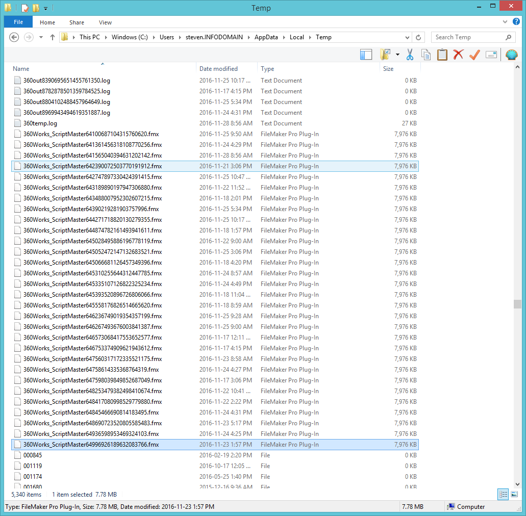

  • There are a large amount temp files created on the client machine which run the fmp to connect the server , the temp files won't removed.
What I am looking for:
  • Any script step can avoid these temp files stay in temp folder.
  • How these files created?
I attached a screenshot.

The current version of ScriptMaster should address this issue. I recommend deleting all the 360Works temp files that are in the temp folder and installing ScriptMaster 5.05 . This version will still create those temp files but it should  delete them. Please let us know if you see them not getting deleted.
