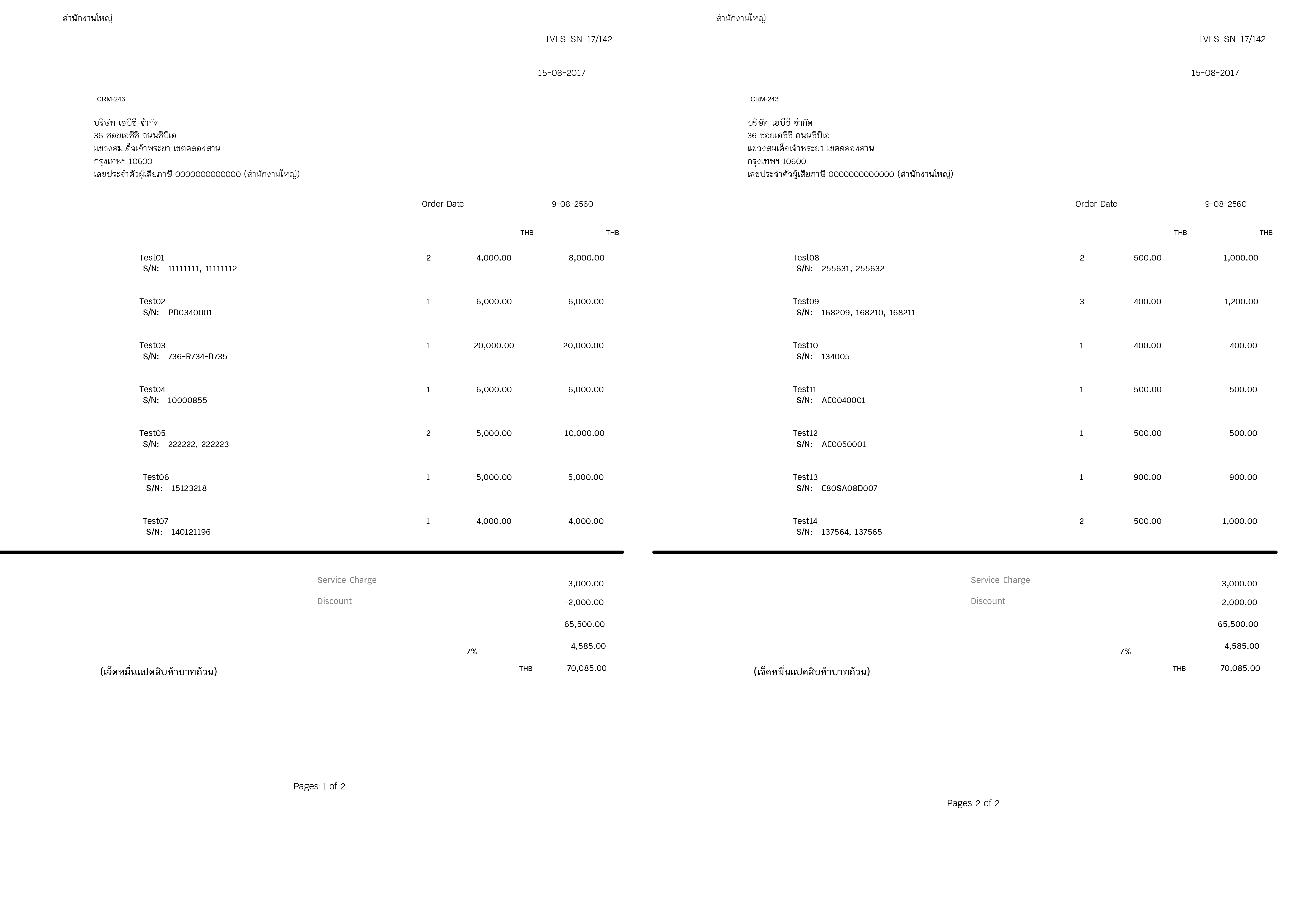

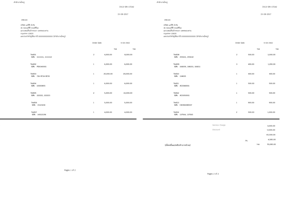

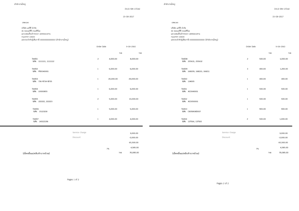

I have a problem making data appear at the bottom of the last page of a multi-page print. For example I have to print a 2 page invoice with the summary data at the bottom of the last page, fix position of summary to match with paper. I try to use Grand Trailing Summary part but the information will not appear at the position of the page and use Footer, show at the bottom of all page, also produces the wrong result. Could you have any suggestions?
That appear from FMP

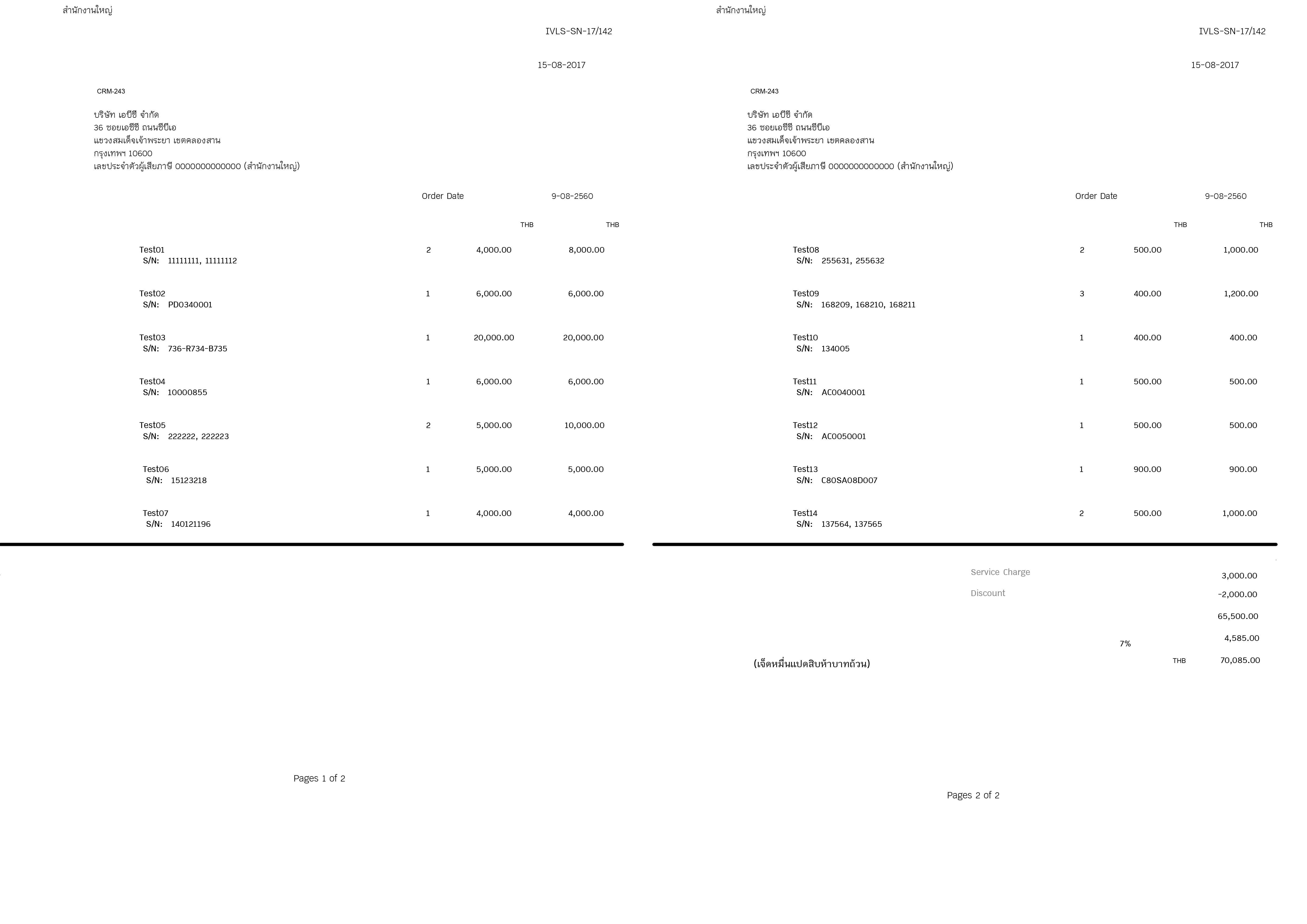

Th is is I need to appear
( I print it to pdf and delete the part that I do not want to appear)
