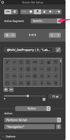

What is an Active Segment in Button Bars? What is it used for?
Edited by john9210
remove accidental uploaded image
In Layout Mode, it's the button you have clicked on in the Button Bar as seen in the Button Bar Setup.
There are several videos and blogs on the Button Bar, since your question is about the Active Segment, start with this one,.
