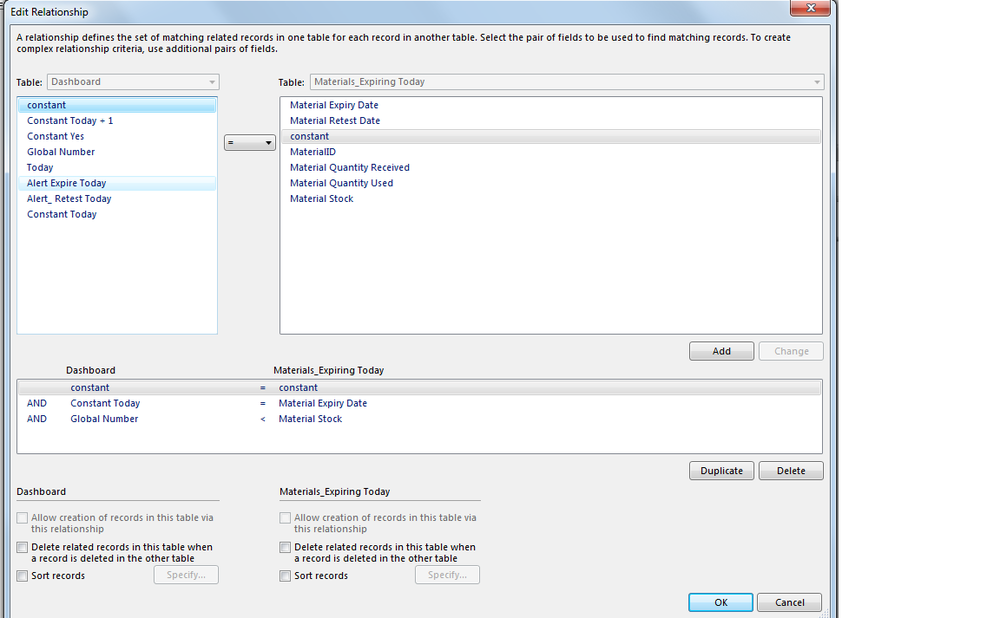

I have a problem with my relationship. In my Dashboard I have an alert that will tell me how many materials are expiring & to be retested but my problem is it showing me a  "?"
The relationship graph is below
Dashboard Fields

If I change my Material Stock into a Number Field It will show my desired output.
That is the correct result. Why is this field involved in the relationship?
And - for that matter; why is CONSTANT involved in the relationship?
Edited by BruceR
I used the constant in the relationship to match the same record.
Is there a way that I can make my Material Stock a Number field but still always show my current stock when I change my Quantity Dispense Field? Thank you.
This makes no sense.
I removed the constant in the relationship..still did not change my result still showing "?"
But you already know this answer. You cannot use the quantity part either, due to the unstored calc.
