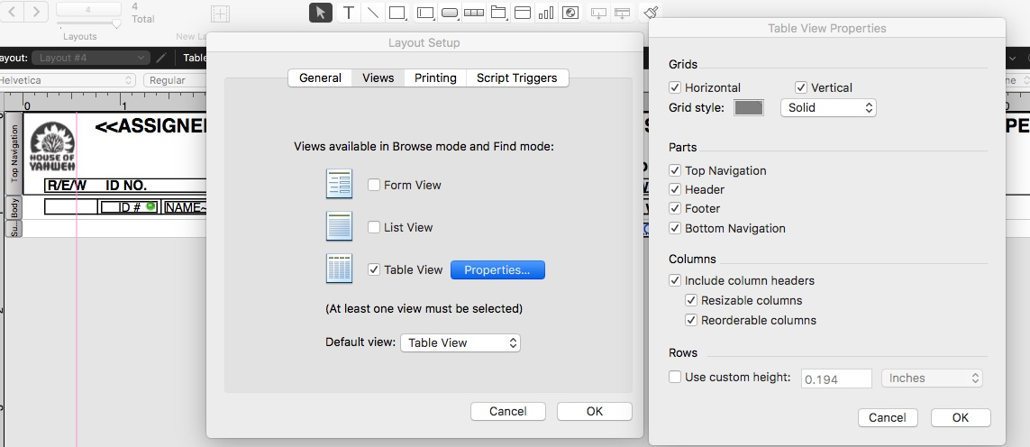

You need to set the layout part to show and print.
Also, change the header type to Top Navigation and see if that is what you need.

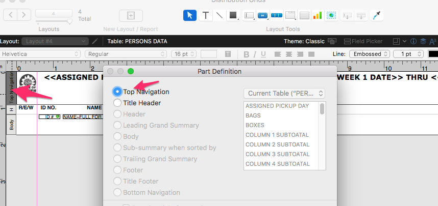

I think have this set up the way you showed it, but the header still won't print. I also tried eliminating the page header, and put all of the items into the Top Navigation header, Sorry to be so dense, but I have been forced into FMP 14 by a problem with FMP 11 no longer working in Mac OS 10.12
Hi John, I got sidetracked yesterday and didn't send this.
In layout mode, double click on your header part and select Top Navigation.
HTH
Sorry Lee, I must be missing something. The picture I sent you shows the header as Top Navigation. Could you please clarify?

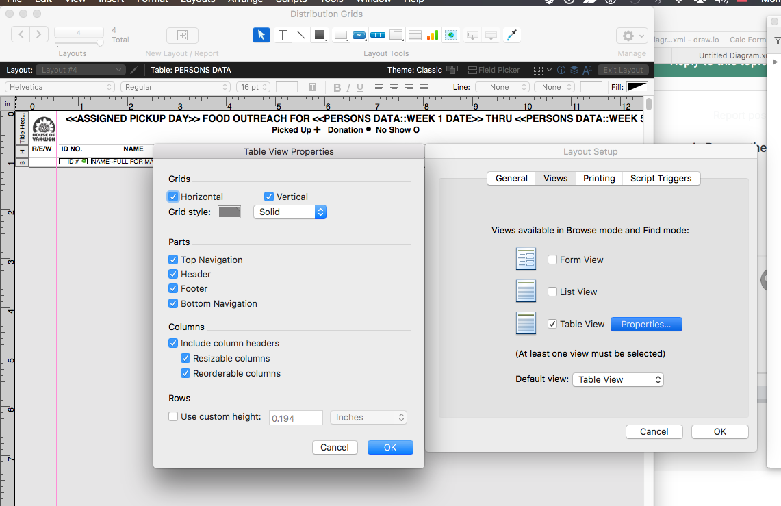

Sorry I'm confusing you. The 2 attachments might help
Your file I modified
Another screenshot of the Layout showing the Part Tab I'm referring to.
Distribution Grids MOD Lee.fmp12

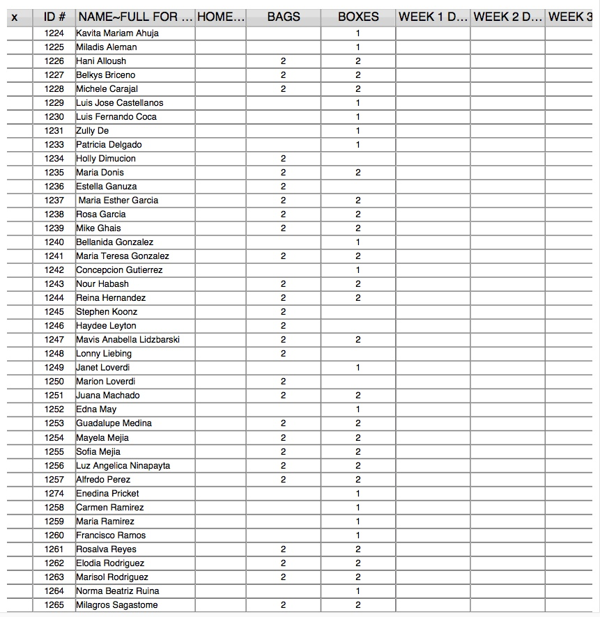

Sorry, but I am still not getting it. The Mod you sent still does not print the headers. As you can see, it prints is a page with no headers and the field names in place of the headers, like this:

Top and Bottom navigation parts are non printing objects - all other body parts will print. (if it shows up in preview it will print )

Thanks, Lee. Yes, this will do it.  Thanks for your patience. I guess I have a lot to learn about the fmp12 format.
Glad It work. It was the order of the layout parts you used.
