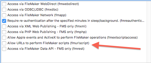

Starting in FileMaker® Pro 16, users cannot call scripts using FMPURL unless and until their Privilege Set is explicitly set to allow them to do so.  Look in the Extended Privileges section.

Yeah, but that's an all or nuthin' approach. I like a bit more granular control. Out of all my hundreds of scripts, only a handful are used with the fmp protocol. It makes sense to restrict fmurlscript to only those.
But can I? It can't be done through priviliges, at least not as far as I can see.
