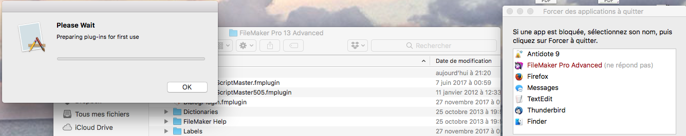

Now if that last version is in the extensions folder, when I launch FMP13Adv I have a panel preparing the pi and some seconds after FMP crashes !Capture d’écran 2017-12-14 à 21.22.35.png

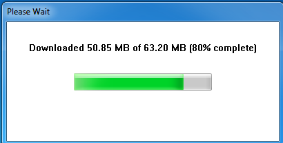

On my PC I get a download
5a336e8b9ce2b_Capturedecran2017-12-15a07_22_28.png.4c1a874fcde153efa174c79fdb26d57d.png
At the end the pi are charged and the error no scriptmaster plugin !!!!!
On Mac and PC If I put the 5.05 edition (found in a backup) FMP runs fine !

The progress bar windows in your screen shots are the plugin downloading support files that it needs to operate. If this download fails for whatever reason then the plugins will not initialize. Please follow the instructions here for your Windows and Mac machines.
