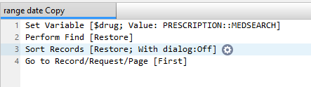

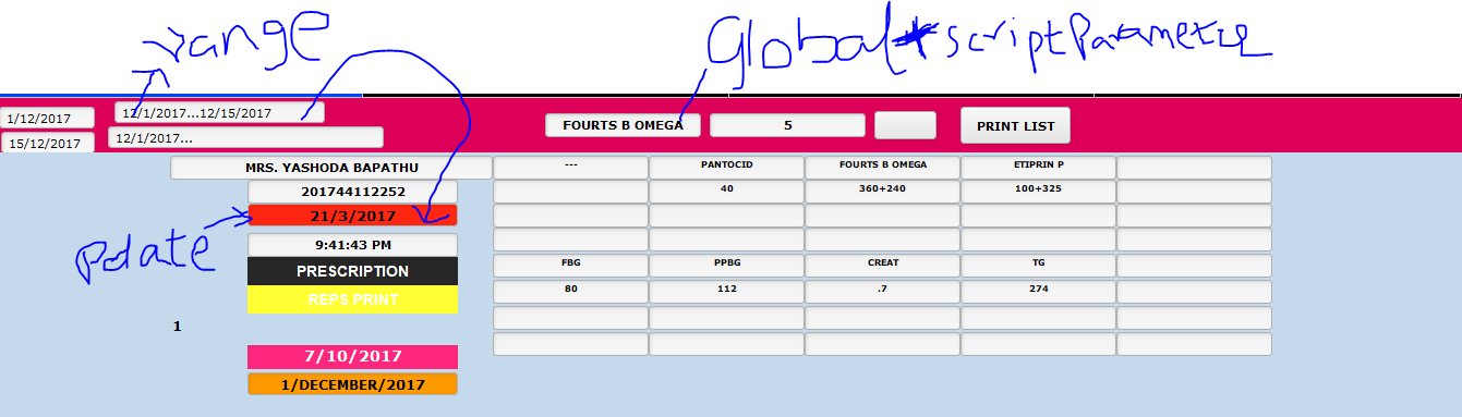

script.PNG.d53147c7096a141f34916e577178bf5a.PNGwhen i am running above script i am able to find for how many patients i wrote particular medication which is a global field giving it as script parameter , but i want to search with date range as u can see in the image , i am trying to give it as script parameter 2 into pdate as u can see in image , but i m not able to do it can some help me please hope u understand

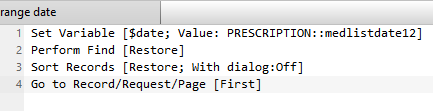

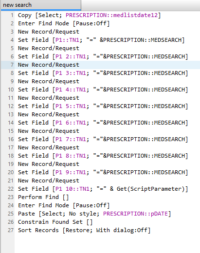

5a3558351a1c8_r1.PNG.ba285cf07fdc23f8d622caa92964bbdc.PNGr2.PNG.72427cdd3d24fec675a83a097b13106e.PNGseparately i am getting correct result but i want to mix both help me plz

yes i did , did same thing u said but cant mix both criteria
r2.PNG.96541f5bf2e94cc7b28b593f31930825.PNGfirst i want drug count then from the found set i want the date range script to run ???

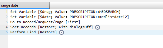

5a355a96c4343_r1.PNG.1282652f0786dacee974b890570932cd.PNGlike this where am i going wrong ????

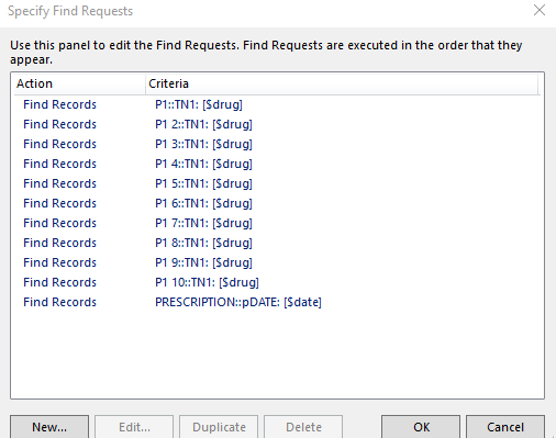

Set variable date and then add the other criteria right underneath in one script. Then perform find. Make sure nothing is left in the perform find.
Edited by Agnes Riley
6 minutes ago, Agnes Riley said:
Set variable date and then add the other criteria right underneath in one script. Then perform find. Male sure nothing is left in the perform find.
ra1.PNG.9ca2b0da08685b7ea7e3964ddbce7e4b.PNGra2.PNG.2c1ba59e52dc8149f85607fd0fdd2842.PNGwith this i am getting total drug count global date range not searching y ????
I'm getting lost here. What is global? I can't see any globals here.

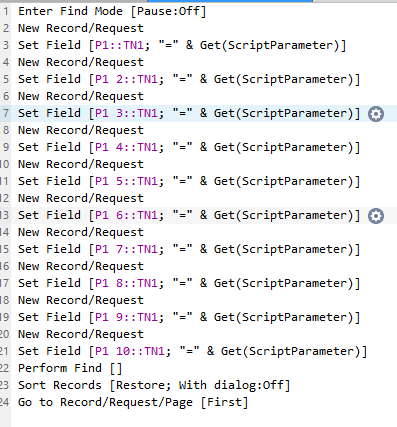

Delete all those from the perform find dialog. Use a loop and loop though the many fields you have (again instead of a table and a portal) and create a new find request. Add the date to every find request.

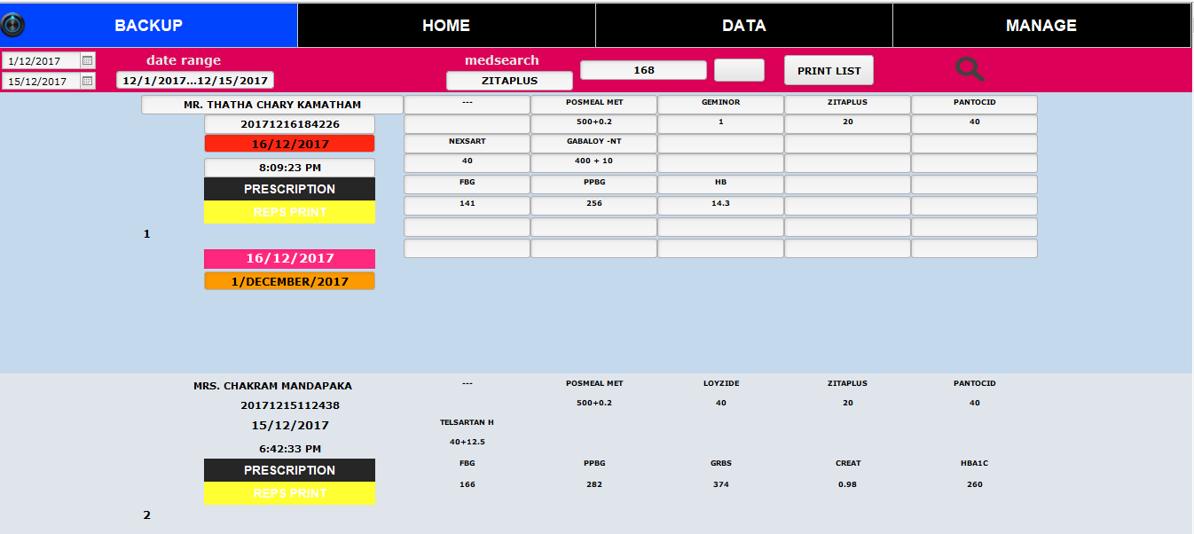

ar1.thumb.PNG.f84ddcb3c10aa308708665ef33aac323.PNGhope u will get some idea ?
sorted.PNG.ad63285ec110c95b7ad977c36112b55e.PNGworking yaaaaaaaaaaaaaaaaaaaaaaaaaaaaaaaaay any other method kindly guide me plz
