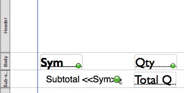

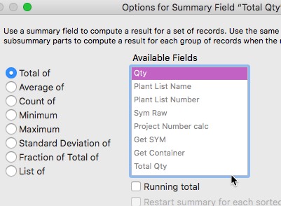

Image 1 shows how I set up the summary field being the total of Sym Raw.
Image 2  shows the layout (I'm confused about the other fields; shouldn't they be in Body?)

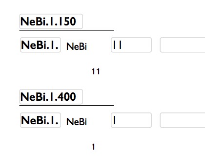

Image 5 shows how Image 2 looks in Browse Mode:
MTP005.jpg.8f736dcc56e878a35552ac64063b2cf3.jpgMTP005.jpg.8f736dcc56e878a35552ac64063b2cf3.jpg
Mighty ugly!

My Total of Qty is a Summary (shown above).

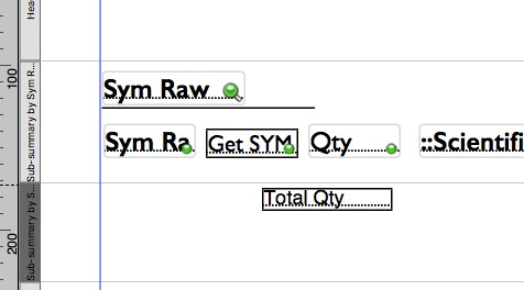

My Layout:
Browse Mode looks like this:
And Preview Mode gives me what I want as well:
So it is exactly what I need, functionally, ready to improve visually. Thanks for the direction, Steve, and thanks, too, to whoever maintains this site, as the way uploads are handled is very sweet.
