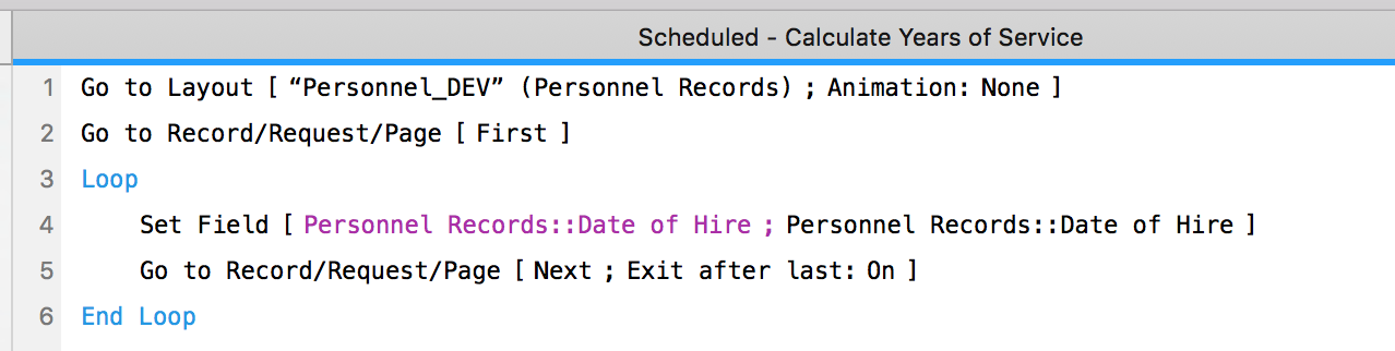

Thanks so much for the detail and really explaining the pros and cons so well.  I have been struggling with this for a while and i never thought about a server script and changing the field type to help my problem.  I made the changes to the field type and it's displaying correctly (THANK YOU!) However I am new to the use of a LOOP script step.  When I made the script i think i put everything in that I need but if it's not too much trouble could you let me know if I have anything that is incorrect or any steps missing?   Right now I have the Date of Hire filed setting itself, is that the correct way to have the calculation reevaluate through a script?
Thanks again for all the info and taking the time to help!

Yes I believe that by 'touching' the 'Date of Hire' field you will cause FileMaker to re-evaluate the calculation as update the Years of Service field.
You may want to put a 'Show All Records' in before the GTRRP [First] step, just to make sure all the records are being used.
Otherwise, looks good!
Thank you very much RWoods.  I will be putting a server script on trial today.  Really appreciate the guidance.
Chris
