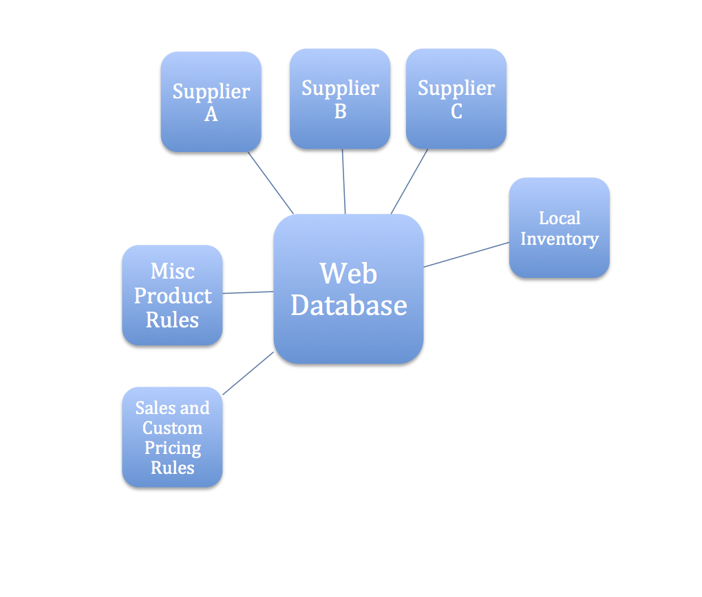

I have done some things to optimize the database but it still seems that these unstored calc fields are what is dragging everything down. I have tried replacing some of those calc fields with text/num fields with "replace field contents" script steps (or auto entry) but it does not seem to make a difference because of the indexing.  The database is not hosted or shared and my computer has decent specs with an SSD HD. I've got a simplified design chart attached for reference.

Regarding the size, the central table is about 120k records. Each supplier table can have between 40k and 200k records...and there are about 10 of those tables. There are a two or three different smaller tables which we use to enter customized information like pricing parameters. There are about 8 unstored calculated fields in the central table that calculate the new price (n_price), qty (n_qty), etc. and it is nice to instantly be able to see what the new numbers will be when we are toying with the parameters.
